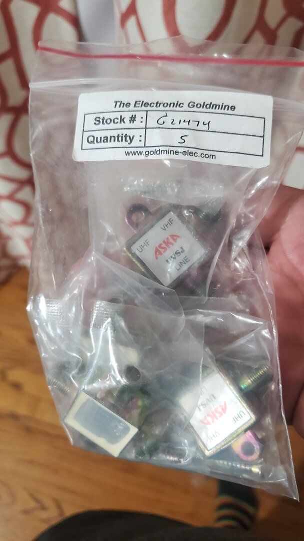

Pre pandemic, I found an obscure site selling ASKA UVSJs for $2.95 each! I bought 5 for the future. 0.5dB loss rating. I don't know if they pass power. I use mine after the preamp power inserters behind the TV. Dual coax into the house for OTA.
Reactions: FTA4PA
