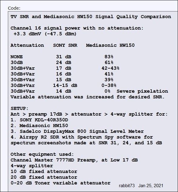

I have compared my SONY tuner with my HW150 tuner. On some channels the SONY is slightly better; on other channels the HW150 is slightly better.

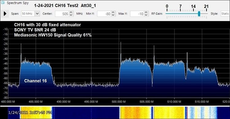

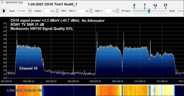

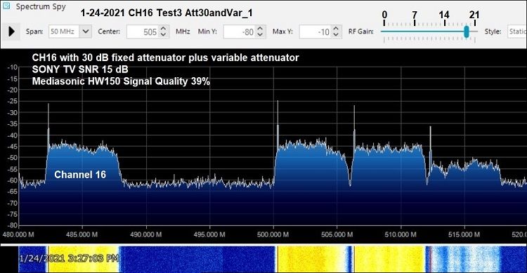

Since OTA channels are constantly changing in strength, it is necessary to compare them at the same time. I use an attenuator and splitter to bring them down to dropout at the "Digital Cliff."
Ant > Variable attenuator > splitter > 2 tuners
In this case, they are about equal:
Here are the screenshots of the CH16 signal at SNR 31, 24, and 15 dB:

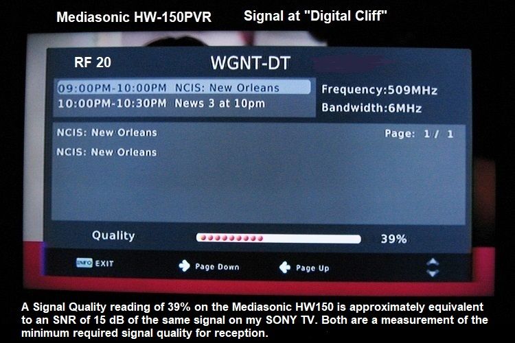

And here is the HW-150 screenshot of CH20 at the Digital Cliff:
For reliable reception you should have a margin to dropout of at least 5 dB. If your signals are so marginal that 1 or 2 dB makes a difference, you need to focus on antenna gain and antenna location.

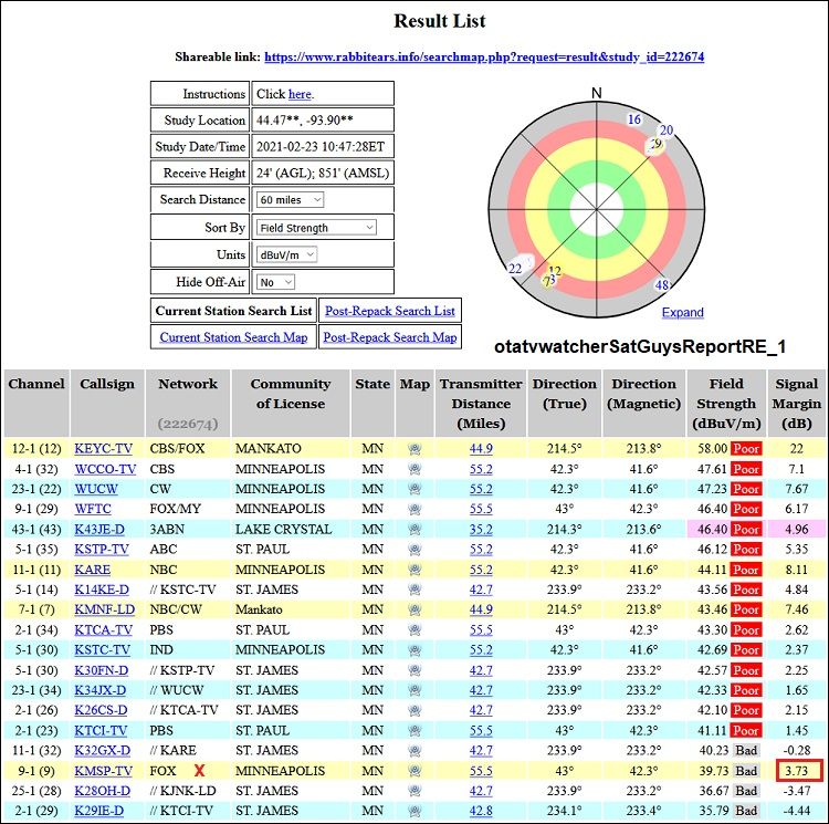

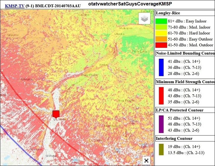

What does a rabbitears.info signal report look like for the signals at your location? You can do a report at this link (I use Google map coordinates):
RabbitEars.Info
A generic report for Falcon Heights, which is a little east of Minneapolis, looks like this:
RabbitEars.Info

The channels we want are the Minneapolis based ones, all in Red on the TV fool site, here is the rabbitears report:
9-1 which is actually down in the "bad" section on the chart is one of the best signal quality we get for some reason.

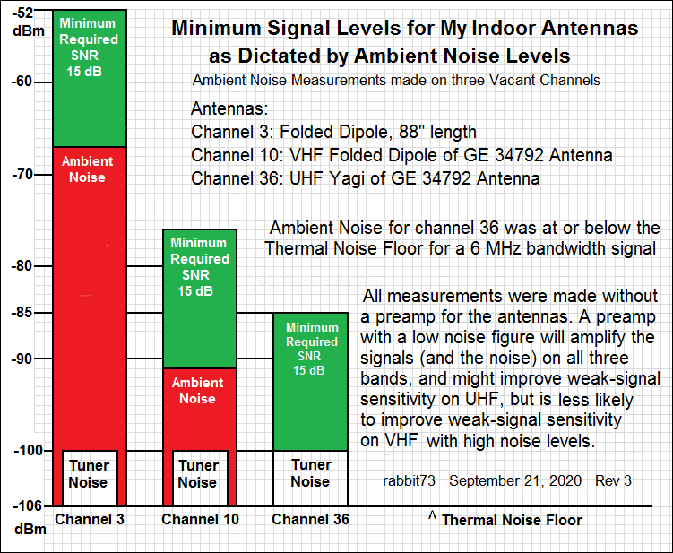

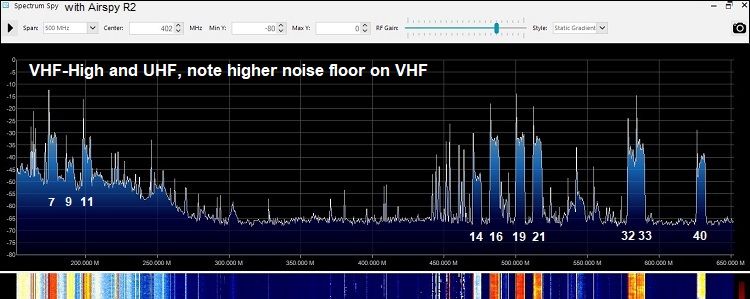

There are limits to the max possible sensitivity of a tuner. These limits are determined by physical laws, the requirements of the ATSC 1.0 standard, and the hardware.
The most important limit is the Thermal Noise Floor, which is at -106 dBm for the 6 MHz wide DTV signal. This noise level is determined by signal bandwidth; the greater the bandwidth, the higher the noise floor. You can read about the theory here:
Signal Strength, Signal-to-Noise Ratio and Other Related Issues in DTV
Signal Strength, Signal-to-Noise and Other Related Topics
The next limit is the minimum required SNR for reception of the DTV signal, which is about 15 dB. This brings us up to -91 dBm for the signal:
-106 dBm + 15 dB = -91 dBm.
The average tuner has an internal noise figure of about 6 dB:
-91 dBm + 6 dB = -85 dBm, the minimum required signal for reception
If the ambient noise level at your location is higher than -106 dBm, then the signal must be even stronger for sufficient SNR. This is especially true for VHF signals.
A preamp can often help with weak signals because its lower noise figure is substituted for the tuner noise figure, but it isn't as likely to help on VHF where the ambient noise level is higher.
Thank you for the report. Your signals are much weaker than the generic report that I did. That looks like the Le Sueur area.
The rabbitears.info report adds a negative correction factor to VHF signals to allow for the higher noise level on VHF. If you look at the Signal Margin, you see that it would otherwise be listed much higher.
What is it that limits you to 24 ft AGL? I have observed that, up to a point, more height is the cheapest wat to improve signal strength.
I'd be really curious to know which signals are giving you the most trouble. Your report indicates a number of co-channel issues.

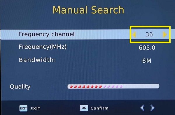

To find out which virtual channel 9.1 you have, tune to it with your Mediasonic, then go into the menu:
Menu > Channel Search > Manual Search
That screen will show you the the channel number on the first line which is listed on your rabbitears.info signal report in parentheses like (29) or (9). That channel number is also know as the RF channel or Real channel.The second line will give the center Frequency of the channel in MHz.
For WFTC it will say channel 29, 563 MHz
For KMSP it will say channel 9, 189 MHz

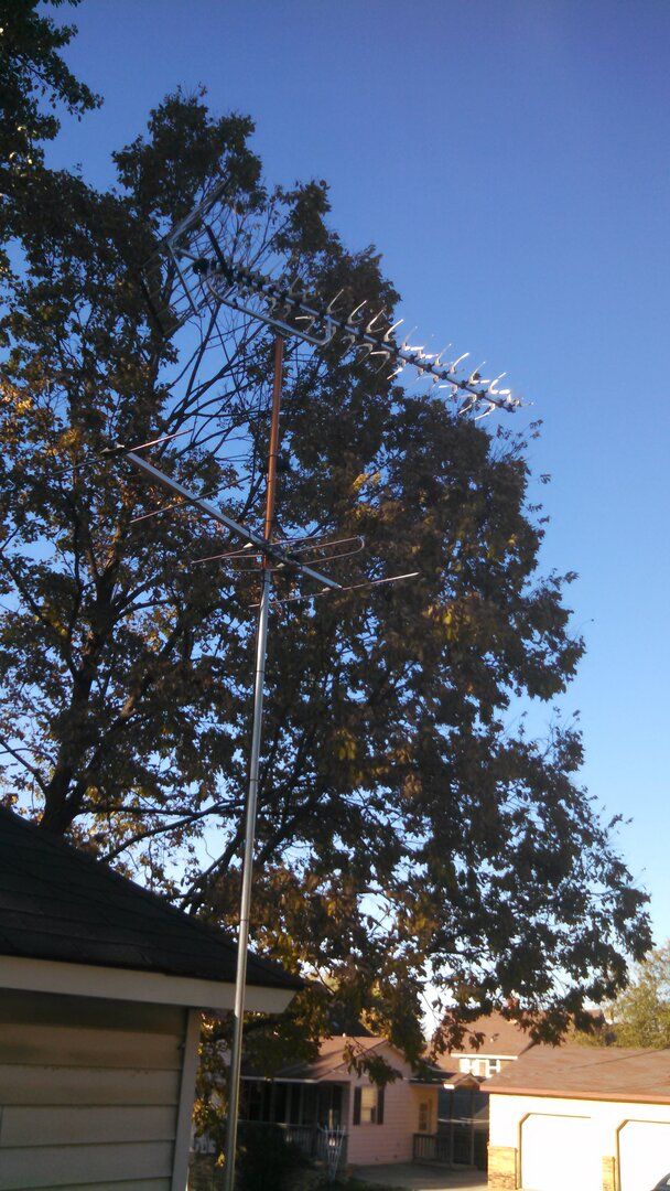

Are there any elements on the HBU55 that are broken off? The gain is only 9.0 on UHF (9.3 on VHF Hi). My XG91 clone has a 14-16db Gain so every little bit helps. The HBU55 is a nice antenna. Bought one years ago but can't use it where I am now. Also is there a way to possibly run a shorter cable? Again every little bit helps. When I ran my setup I threw the cable across the roof to save about 40 feet of cabling.
