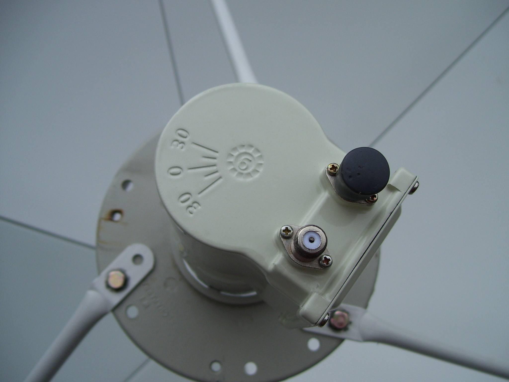

The geosatpro C2 the skew is off by 90 degrees. Its a known issue
so if you are setting the LNB at "0" it needs to be at 9:00 or 3:00 (if visualizing a clock)
no. On the LNB you'll see 30///////0/////30 on it (see pic)
That is how the skew should be for 0 skew (if being put on a motorized dish). If a fixed dish you have to skew for the proper satellite
