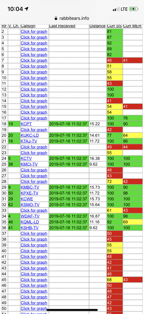

Hey Neil, check out Post #18. In Lee's Summit, KQML is actually stronger than KCMN for some reason-
Where I live in Liberty, both KQML and KCMN have a stronger signal then KAJF?

They may be sending the signal in a directional pattern. Sounds like perhaps KQML and KCMN are directed north and east, where KAJF might be directed south. I'm not an expert, so maybe Trip can weigh in-

All three are omni. Local reception conditions may vary even for stations coming out of the same antenna due to local obstructions or due to different performance of either your receive antenna or the transmit antenna at the different frequencies.

When an omnidirectional transmit antenna is side-mounted on a tower there are significant reflections from the tower. The reflections tend to create a scalloping of the pattern with deep nulls in some directions. The scalloping varies with frequency and the distance between the antenna and tower. I would not draw any conclusions when comparing two side-mounted LPTV stations.

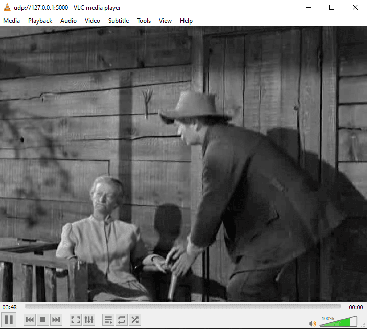

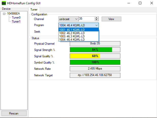

KQML now has a .4 sub-channel which appears to be GRIT.

Have you been able to confirm it's Grit?

No, they don't seem to have any call letters or identifiable graphics. I watched for about a half hour earlier and only saw that show and commercials.

That's just the Infomercial / Classic TV subchannel that HC2 has been putting on a lot of its stations. A lot of old public domain shows (Bonanza, Beverly Hillbillies) but very little variety. I saw the same back-to-back episodes of Bonanza three nights in a row. My local HC2 station shows an hourly station ID but no network ID.
