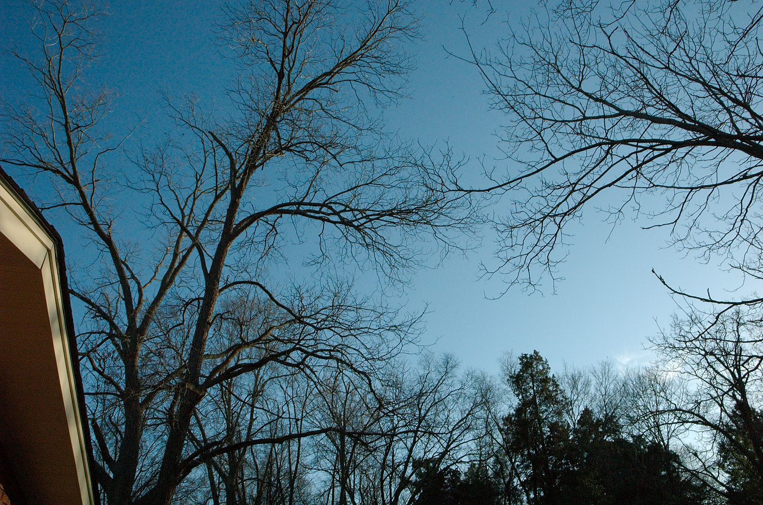

I ordered DirecTV and the installer came out today. Nice guy, seemed to have a pretty good idea what he was doing, but he didn't strike me as a seasoned veteran. He surveyed the property and the best he could find was a single spot that still wouldn't work without trimming some tree branches (which is feasible). But really if I'm going to that much trouble I'd prefer to have the dish in a less conspicuous spot. He called his supervisor and I confirmed that he had explained the issues to me, and the installer left. The order was canceled, so I'm not sure how to go from here.

If it helps, my ZIP is 39759 (Starkville, MS), and you can find a picture of the LoS issues here: picklematrix[dot]org/temp/directv_trees[dot]jpg
That picture was taken from my preferred location (give or take), facing south(ish). The installer said that the first satellite would be blocked by the long, tall limb on the left.

...and yes, many are very conservative, BUT looking at that picture without leaves, may turn out to be a real no-no spot after they come back in, I took the liberty of uploading here for others to see; easier.

I would call D* and have them come out again, you never seem to get the same guy twice anyways, see what a second opinion gets you.
As for the position you have posted, are there any other locations possible.
Depending on how your trees grow in, you may have problems in the spring to fall seasons, but you would be the one to know how much growth you have there.
IF you have D* come out again and they still cannot find a spot, then I would try a local guy, D* would be free, I believe, a local guy may charge a service call... If D* does it, the install, (Dish, wiring, Multiswitch ect. ) is free, if an independant comes out, you may have to pay for the equipment.

I doubt they would pay a 3rd party install cost. Even if the directv tech installs it, they will charge for pole mount, and will charge for burying wire.
Sounds like it will cost something any way you go, given the limited options you have with the trees.
I'd get a quote from the 3rd party guy, and then wait until the D* tech comes out, see whos it more reasonable.

dboyles, make sure that when the next guy comes out, you ask for a second opinion if he can't find a line of sight for you. i work the starkville area, and our supervisor is very good at finding any and all possibilities for you. just make sure they don't cancel the job, just put it on hold for a second opinion.
also, borrow the tech's inclonometer for a few seconds and let him tell you the exact angles he needs to have clear. together you may find the perfect location.

What is there on the opposite side of the house? Take some pics and post them. If you're getting HD you need a MINIMUM 20 degree opening, preferably with +-5 degrees on either side. You're elevation setting will be a little higher since you are farther south, that may or may not help your situation. We're told we have to guarantee service for one year or we aren't suppose to install it. Which is probably why the tech was a little hesitant. He did the right thing by calling his supervisor AND if his sup concurred then it's done. Supervisor will find any way possible to get a job in. It affect their bottom line if they don't. So if he agreed with the tech, and if that spot is the best location and it still has issues, then you have some things to think about. And not just "trimming", from those pictures one or both of those two trees needs to be seriously shortened to open a good sustainable line of sight. The over hanging limbs for sure, but possible down to the crowns, I can't tell how high they are. Comes down to how badly do you want direct, and what are you willing to do? I will tell you Dish won't be able to get LOS from that spot as it is right now either. Some things to think about. Can it go on the house anywhere? With that amount of tree coverage, the higher up you go, and the further back from the trees you get, the better off you'll be.
