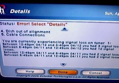

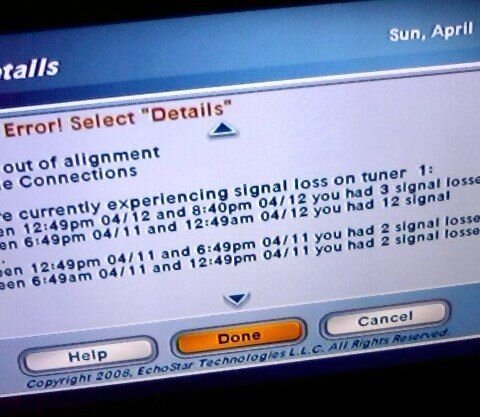

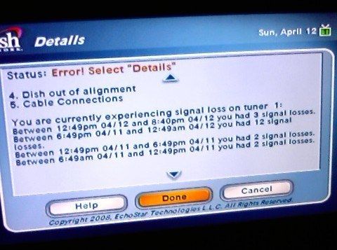

I am attaching some pics I took of the screen.....a new one showed up this morning on the local channels.....

Aug. 07 = 20 months.
Models: 625, 522, 322, 301 Using DVR's in Single mode.
Dish 500
No upgrades other than putting in the New Smart Cards I got in the mail last week.....only the 301 had one in. Put New Cards in all 4 now.
Grounding block in box on outside of house where cables fro LNB are attached to a diplexer/splitter:what anyway seems to be grounded O.K. at that point.
The tech is coming tomorrow...I did see a kink in the wire outside and told him about that, so hope he gets that replaced tomorrow.....:bow
