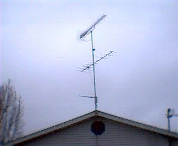

My antenna setup. However, the bottom antenna is lower. The bottom deflecter sits on top of the PVC pipe the mast clamps are attached to.

You live a messy area according to your TVFool plot if I recall so the likelyhood of getting 16 channels is a hope and a prayer in my opinion. Not saying it can't be done, but you have to be situated right to do it. 43 channels is the most I have heard about but I am sure there are others that get similar results. Oh, BTW, I worked in the CATV field for over 27 years so know a little about setting up antennas. ;)
As I said. It sounds like a bad fitting/connector/power inserter either corrosion, water or poor quality materials. The wind might have blown the antenna off alignment. You could be getting multipath now with no leaves on the trees. A building could have been built causing multipath. A whole slew of reasons that it could be but it will be a process of elimination to find the cause(s). Check the balun connection, the balun itself, the fittings, etc...

alright im back to my original channels now, the antenna must have been blown off by very little. so this morning i woke up and it was blown to about 90 degrees off so i figured i would scan just to see what happened, i picked up like 5 extra channels i wasnt getting before. i am wanting these channels, but in order to do that i would have to be pointing at 2 different directions at the same time, does anyne have any suggestions on how i would do this? i would like to get all the directions at once, it looks like you are doing this and thats how you have so many channels.

You won't know until you shorten it the 5'. We hope it won't affect anything negatively. To point at 2 directions at once, get another antenna, depending on the band of the desired new channels. You see my picture. That's how it's done. ;)
the problem with additional antennas is i already have 3 on my mast already. would the vertical antenna like you have pick up from all 4 directions? and would it have the strength that mine does? to be able to get about 75 miles away? i think i have this one
