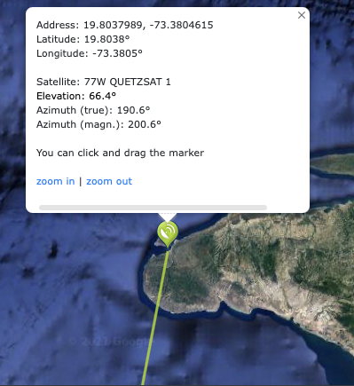

These are my coordinates-
(19.8037989, -73.3804615)

Nice, just re-aim that 1.8 ft. to 129°W
The antenna should be an Off set fed antenna, therefore most will use between -21° and -23° of the original target elevation depending on the manufacturer (Dishpointer.com also on app helps to aim)
Your 1.8 ft. is actually aimed to 66.4° so use the angle app on your phone or a digital angle meter to calculate the degrees your antenna needs to subtract from the original elevation, I will work with 21°; assuming this your antenna is more or less at a 45.4° Elevation (really 66.4° for prime focus antenna).

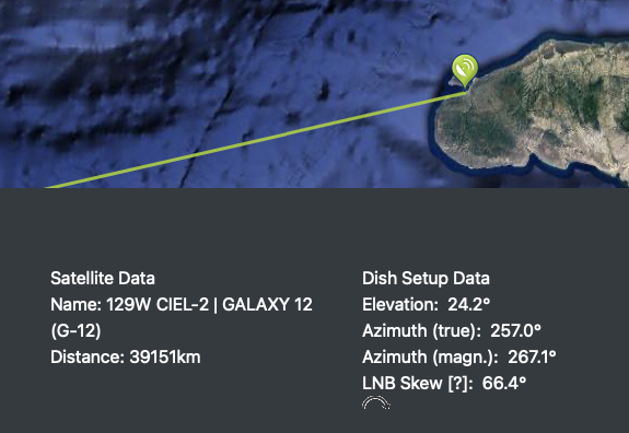

Your new target is 129°W:
The Elevation here is 24.2° minus the 21° leaving you with 3.2° (almost vertical)
Hope that gives you a rough idea...
Good Luck!!!

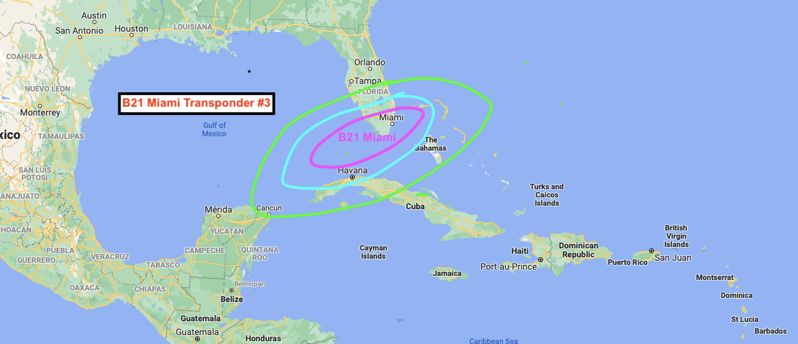

If I recall you said you are in Cancun?, 15 and 16 are a bit low. if you don't want to spend money on tests the best is the NY local in SD out of 119°W. My guess is the LNBF's location or the antennas surface is giving more gain to the orbital slot 110°W.....just guessing here, there are several things to test before posting any kind of suggestion....
If you achieve more levels from satellite Echostar 14 @ 119°W in the following Transponders (Spot Beams):
TP #1 & #5 A20 that serves Tampa (SD).
TP #2 B20 Fort Mayers (HD) Miami.
TP #3 B21 that serves Miami (SD).
TP #4 B20 West Palm Beach (SD).
Just to give you a slight idea (example) of the spot beam you might be achieving (based upon your posts):
Still looks as best option SD out of NY.....

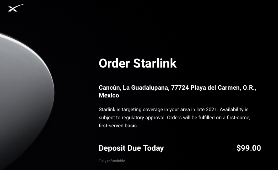

Great, good luck with the tech, I would say you might not need his services (by now) because with your current setup you will get locals of New York, NY in SD from 119°W @ Transponder 20; Transponder 20 is a CONUS Beam not Spot Beam.
The company in Miami (Kiwisat) has a very strong footprint in Mexico, central America etc (Miami Locals in HD)......the 1.8 m will be almost weather proof for that SES10....(lol)
Unless you have a very good ISP the satellite could be a better option, you need at least 4 Mbps for a decent streaming; most likely very soon your area thru Elon Musk's Starlink will provide you a 90 Mbps + for $99 a month I don't know when you will have it available in Mexico.....

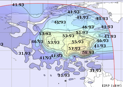

question i have a chance to get a 2.68meter dish very cheap... if i used that for sat 119/110 instead of my 1.8meteer would i get better reception. i have been looking at 119 reception different times of day thought i would do a small study...seen some go lower..
maybe im doing something wrong but seems kiwisat website is down
Post pictures of that antenna they're offering you, there where are a lot of informal companies copying antennas, as a matter of fact there was one in Mexico (can't remember the name of those guys) that copied from a company in US Idaho (formerly know as Andersen) the copies will never perform as well as the originals, so your original Channel Master (by the way one of he most copied antenas in the caribbean) could outperform a 2.4 copy......
