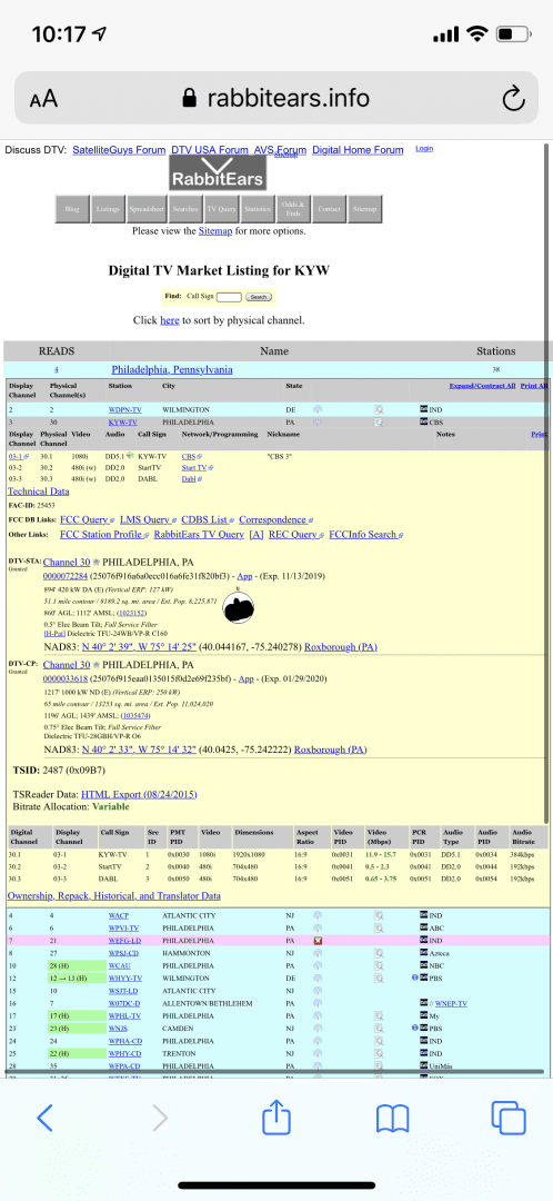

Looks like they may be operating on an STA until they get their main transmitter operational again-
Under that data I see DTV-STA had an expiration date of 11/13/2019 which is right about when I lost reception but I'm not sure exactly what that means?
