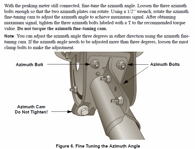

BTW - I was looking at my 1000.4 last weekend... I can see the elevation vernier rod; that's obvious. But for the life of me, I see no azimuth vernier. Did my installer leave it off?
It doesn't have one.

Except there is supposedly an
Azimuth plate and cam [which] provides for fine-tuning of the azimuth angle.
I saw nothing like that either. Perhaps I don't now what I'm looking at. Aha... Here we go:

Except there is supposedly an I saw nothing like that either. Perhaps I don't now what I'm looking at. Aha... Here we go:
The "cam" is on the right back side (looking from behind), chances are the cam snapped off when the installer was trying to move it +-3 degrees. If you don't loosen the three bolts on the bottom, that cheap plastic cam nut will snap off and go sailing.
