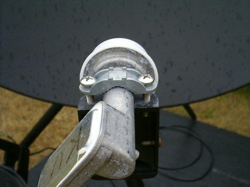

the Primestar lnb has a LO freq. of 10.750 which is standard for standard ku feeds. I would prefer the round ones if you can find one. I use two round ones at work. I receive The Pentagon Channel off of AMC 1 ku with one of them and I receive WSBK off of F1R ku with the other.
Pretty easy to replace the LNB, but some members have struggled understanding that the LNB has to be at the EXACT same height and distance from the dish as the original LNB.
I crack open my LNB's and use the 20mm neck to get the exact focal position.
Best idea is to leave the feedhorn that comes with the dish in place and replace the LNB only with one of the Low Noise Invacom LNB's
You will never get Digi II on a FTA receiver but there is still a plethora of FTA channels available up there!

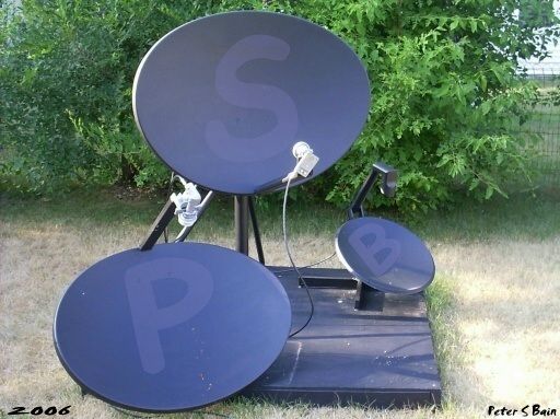

Some more close ups of a regular LNBF modified to fit a PrimeStar dish........
