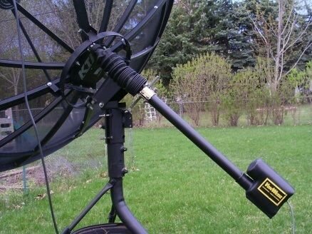

Good idea, I am spoiled now with a new actuator and a 6' dish (below), but its a fun project and the main thing is when set up correctly there is no more elevation to worry about, just east and west!
