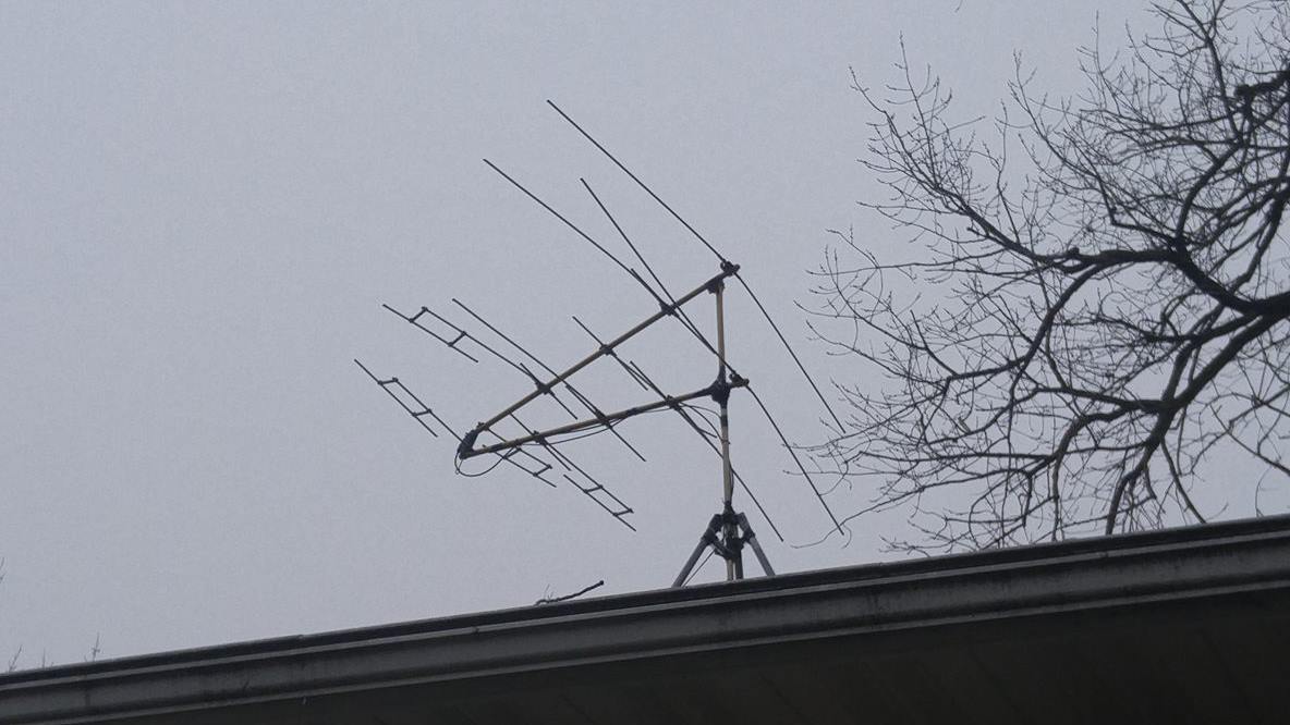

This is a picture of his antenna. No wonder he's not receiving any channels. I never saw an antenna like this.

I have dealt with TV antenna installs and such for years and have never ran into that type of configuration, used for receiving only. I would like to see that antenna even closer up, just for my own curiosity.
For sure VHF spacing and length though. He needs something tuned for UHF for sure.

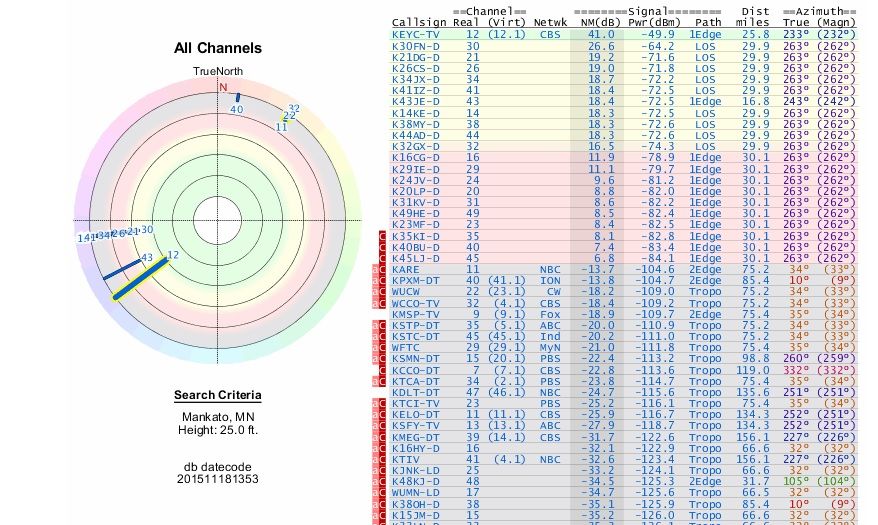

A little confused over his TVFool report. Why no virtual channel numbers?
All of those at 263 degrees are the low powered translator system I spoke of earlier
http://rabbitears.info/market.php?mktid=239
since the PSIP numbers have changed every now and then they arent listed on TVfool (plus their FCC base doesnt list it usually). The 1st few on the list (down to about the end of the yellow ones) are the main Minneapolis stations. And yes KEYC is on THREE RF stations
12 (the "mothership")
38 (a translaotr owned by KEYC at the Godahl/St James tower...so folks with UHF only antennas can aim there)
41 (that was WCCO MInneapolis (CBS) but they must have an issue so its swapped to KEYC
Looking at that closer, that is most definitelly a VHF only antenna. Old one...He will need a UHF antenna to get the rest of it but can be done (probably need a basic pre-amp too)

same here. But I've seen older VHF only antennas like that. Again its a 1 station market that we're working with and back in the analog days folks aimed NE for Minneapolis (80 miles away). The analog stations were 2,4,5,9,11 (PBS, CBS, ABC, IND, NBC)
An elderly relative has an antenna like that. It's never failed, it's the only antenna ever installed on their house. Literal LOS and within 15 miles of Mt Mansfield means that it works since the transition as if nothing happened. The VHF Montréal channels are flawless, too. Before the transition, UHF was weird looking, snowy, no Montréal, and missing the lower power channels, but ABC and PBS were watchable.
The TV it's attached to is ancient and stops at Ch 36 (I think) so the digital transition gave them Fox 44 and WCFE since the analog tuner didn't get them, but the converter box did.

Now that Winter is over, my friend is ready for me to ship him the 8-bay UHF TV antenna and a pre-amp. However, now that I have his exact address, the TV Fool report doesn't look as good. Will an 8-bay antenna and pre-amp be good enough? Also, is he required to pay $7 a month for the OTA channels? I never heard of paying for OTA TV.
