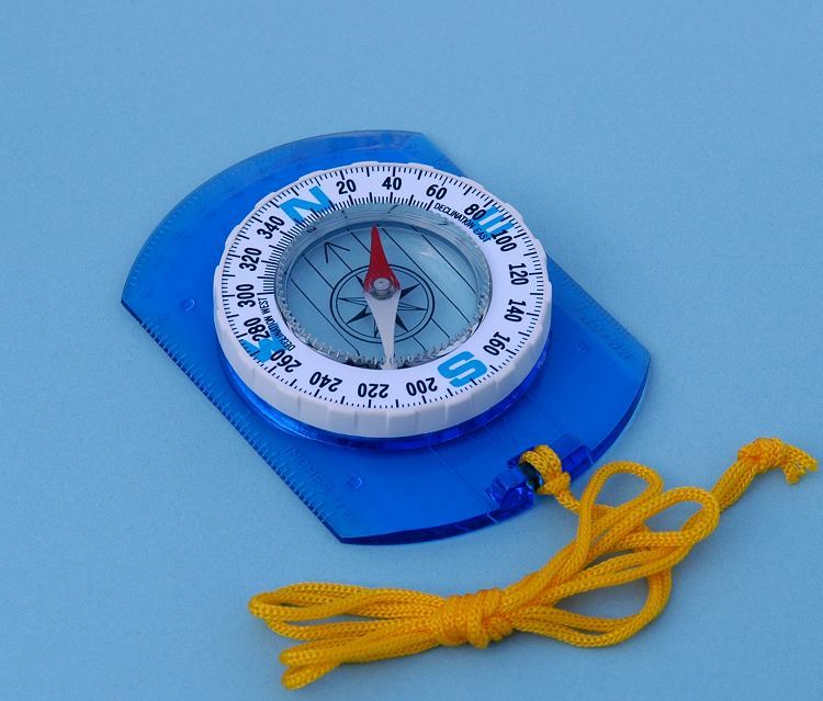

Good luck and remember to post to let us know how it turns out. Be sure to get a heading compass to properly aim the antenna (everyone should have one in the toolbox any how). One channel ( KMVU-DT FOX @ 78°) is "off" from all the others; so I would aim at the 309° heading first to see what happens.
