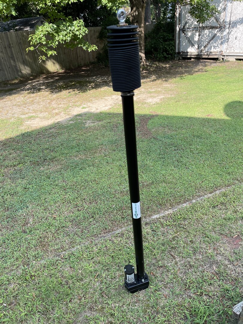

I finally received my new 46" actuator today what a monster

It was just worn out, it been up there since for about 15 yrs.. I installed the new today night and day difference.
I did have one small problem with the new Venture actuator they didn't install the boot correctly, it was clamped down on the actuator way to high up on it,I didn't notice that until I went to go one of the most western satellite like galaxy 30 125 w and it wouldn't go all the way down.
I think Venture must be a small type of business operation the reason I said that it took them 3 weeks to make it, and it looks like they are working out someone garage pictured below. But it really doesn't matter they did a good job and if any ordered one from them make sure you check your boot before installing it.

Now days, Venture primarily manufactures actuators for commercial applications, gate openers and RV slideouts. The satellite version of the actuators are built on demand between the runs that pay the bills. Fortunately, the original Venture owner's son still runs the business and recalls his father' building the first actuator at the family's kitchen table and retains the passion for supporting the satellite industry.
They have been around since 1971, have a 45000 sq ft ISO 9001:2015 certified manufacturing facility and 5000 sq ft of office space so I'd say that's a pretty big garage! ;)

Ok I was going by the picture they sent me ... I believe you..
Reactions: FTA4PA
Ok I was just wondering that mess sense now..
I think what you said makes the most sense, they might just be using little part of there of there company to do satellite actuator, but if you get one from them make sure you check the boot, the actuator need to be fully extended then put the boot on and it will be correctly done.
One question according to their paper work it never needs to be greased is that so ? with the built in boot?
Have you tried grabbing the clamped boot by hand and move it down the tube by twisting and pulling it down bit by bit? You may just be able to get it to move a couple inches. If not you can always cut the clamp and replace it with a new hose clamp.
