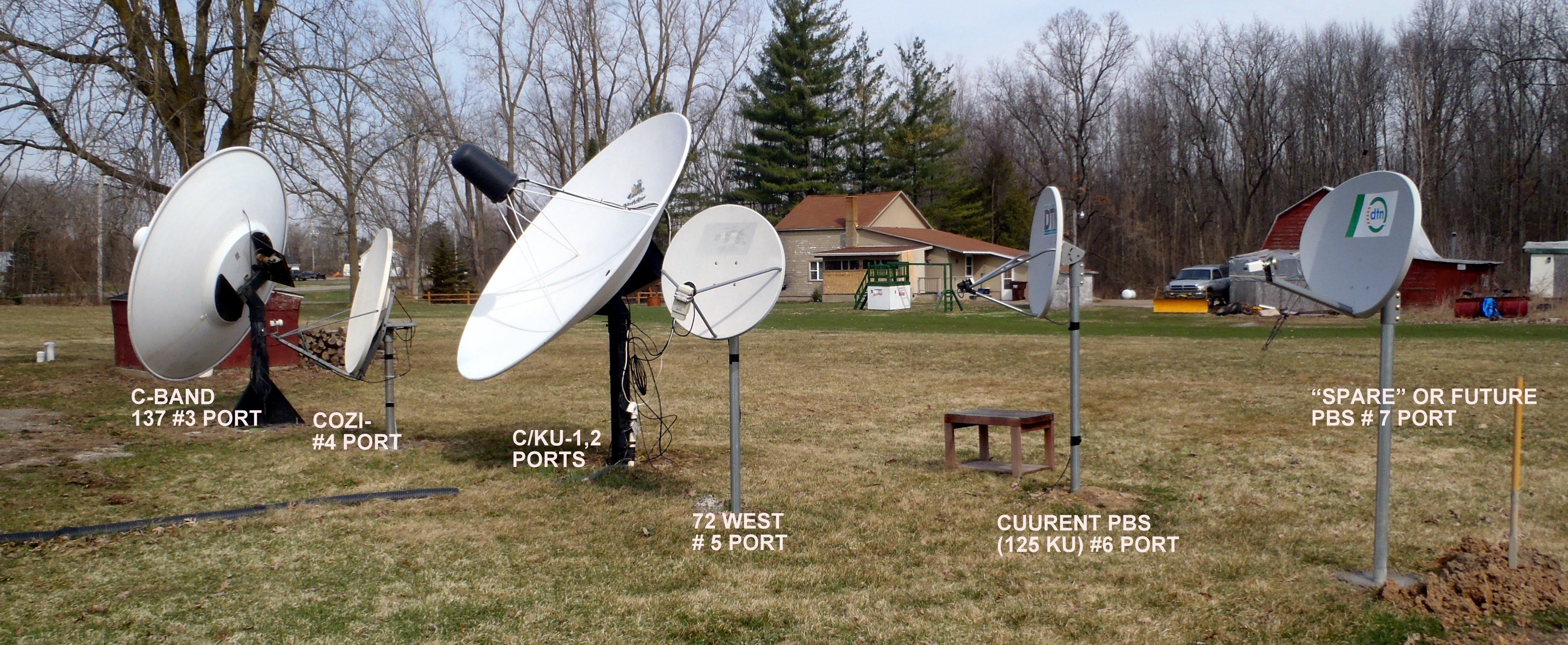

Picture shows what I'd like to do with teh 8-port if I can make the MicroHD understand it all.
Yes in the menu on the microHD use the first 8 of the last 16 ports. :)
That is the way I have mine set up( even though I don't have a C/Ku on the 10 footer right now). Come off of the C-Band dish with two coaxes, C to say port 1 and then Ku to port 2. Then hook up the other dishes how ever you want that makes sense and easy for you to remember which one is port 3, 4,5, etc.
