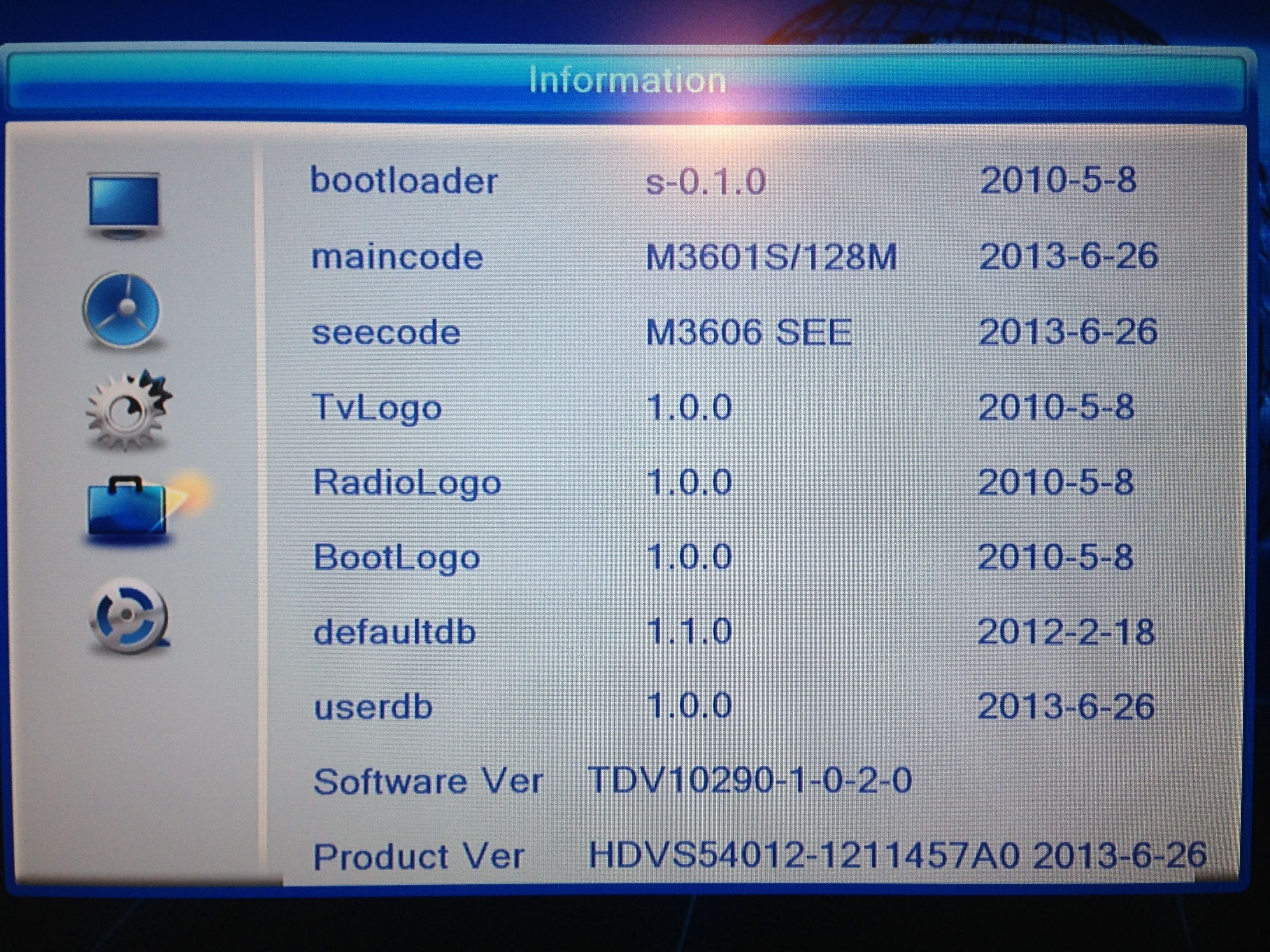

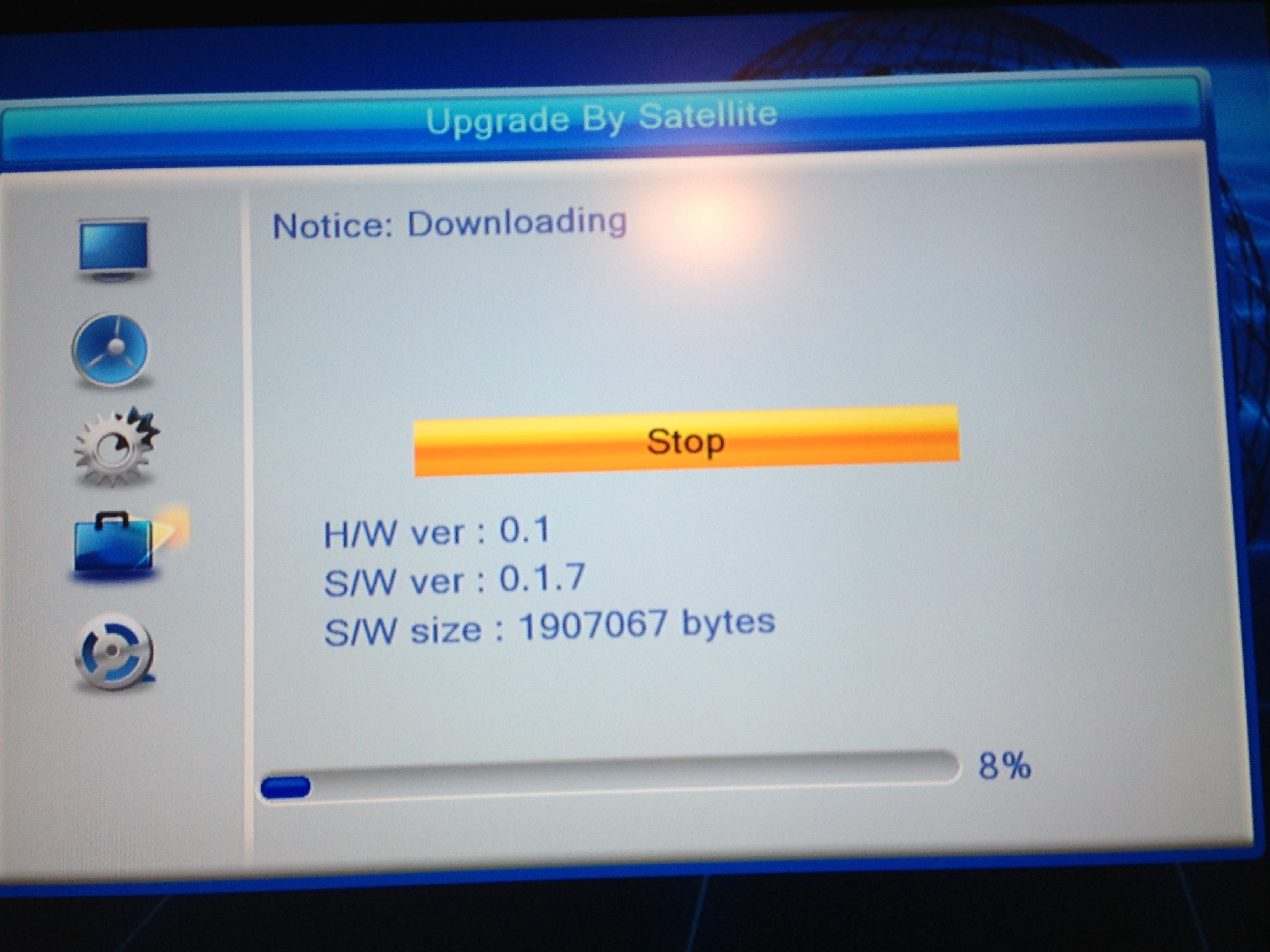

I thought maybe it could be a firmware issue so I checked and the firmware was dated 2/18/13.
So I saved my channels database to the disk then I tuned to the update channel on G19 and did a firmware update to the current one, it's dated 6/26/13 now.
I rebooted then reloaded my channels database.
I am hoping this will fix it. I guess I'll find out tonight at 10:30 when it's supposed to record Harvey toons.

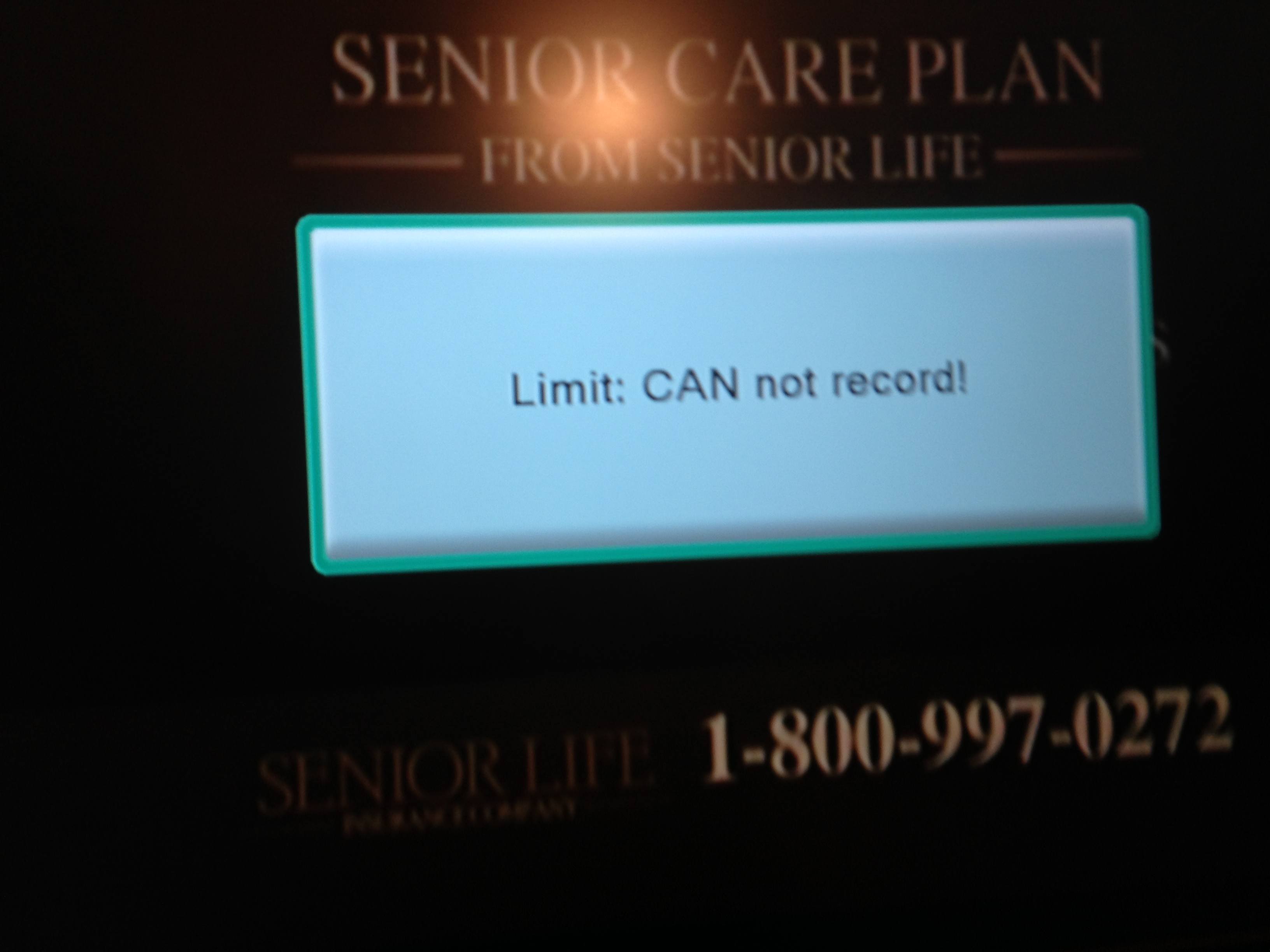

When I press record a message pops up that asks if I want to record PS or TS, either one I press I get a message that says LIMIT: CAN not record!
The red recording light comes on however and then stays on even through channel changes.

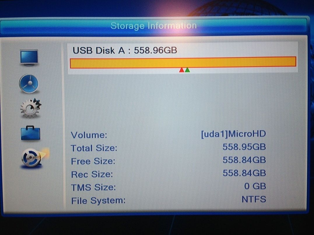

The disk is far from being full and several months ago before I dumped it to my Mac, it had 10 times more files on it than it does now.

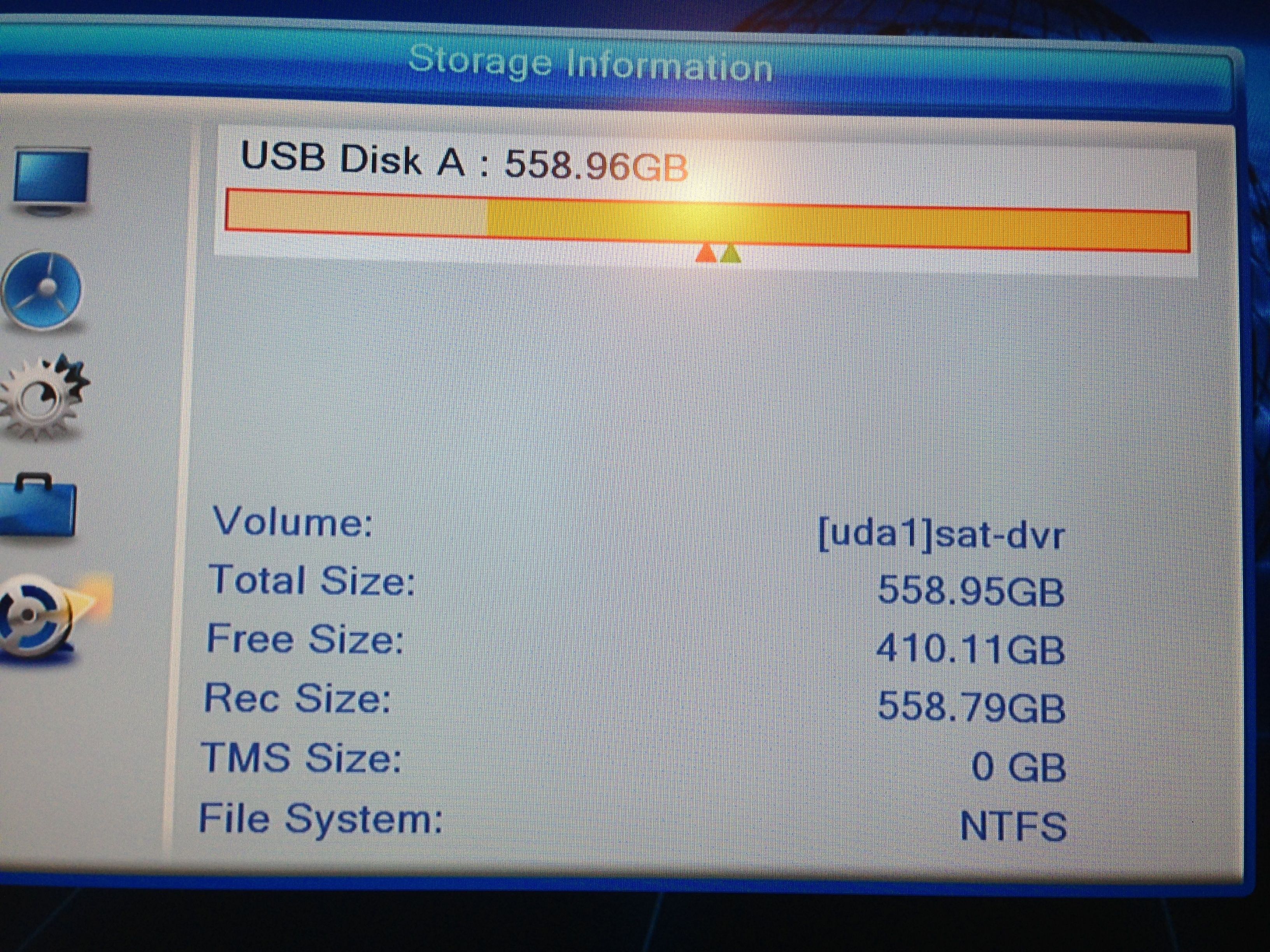

Here are a few relevant screen shots... I have no idea what "TMS Size 0GB" means but could that be what it's blowing up on?

Oh, sorry about the big photos. Stupid iPhone takes crap grade photos at gigapixel file size.

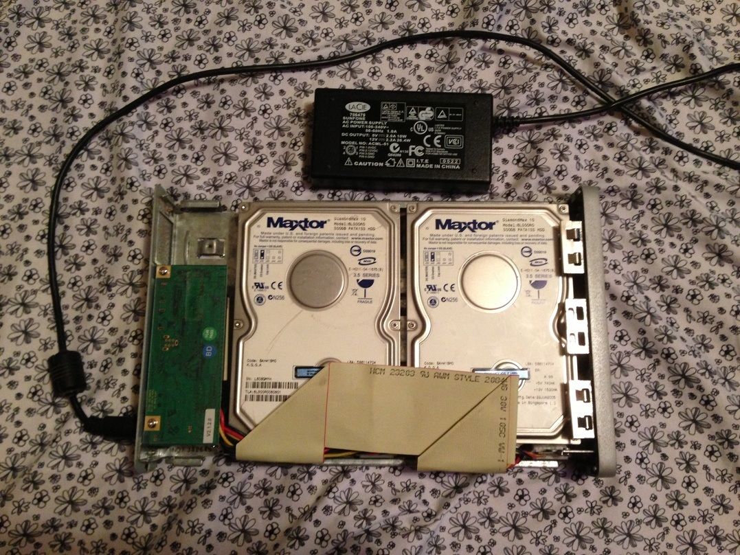

One thing I should also mention, the disk is powered by it's own power brick, it's an old Mac disk that I formatted for windows.
I have saved stuff like the allcode file, the userdb, etc. then reloaded them after the upgrade (but not the allcode, only the userdb)...
I can play back ANY of the previous recordings just fine. It has no problem reading from the disk. And it let me save it's firmware files to it as well.
It just doesn't want to record TV for some weird reason.. ???
edit: Attached picture of what the disk looks like. It has two 300gb disks inside the case.

There is an indexing issue with the drive. Do you disconnect the drive in the microHD menu when disconnecting?
Try a disk repair using the computer or transfer the recordings then slow format.

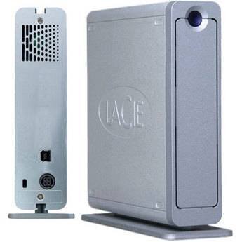

Ooops.. No, I didn't disconnect via the menu. I just pulled the power cord on the tuner then removed the USB cable.
It's a LaCie brand and when what ever it's plugged into shuts off, the disk powers off by itself then powers up when it's host powers up.
I still went ahead and removed the USB cable though and powered up the tuner. After powering up the tuner I plugged in the disk and it powered up on it's on and the tuner gave me the message that the disk is connected.
I guess it's messed up though from what you are saying so I'll remove it, dump my recordings to my Mac, format it as an HFS Mac disk (only takes a few minutes) then plug it into the windows PC and have it do a sloooooow windows format. I did that several months ago and it took HOURS.... After that, should I then plug it into the tuner and have the tuner reformat it again? Or just leave it as it comes from the PC, formatted slow as NTFS?

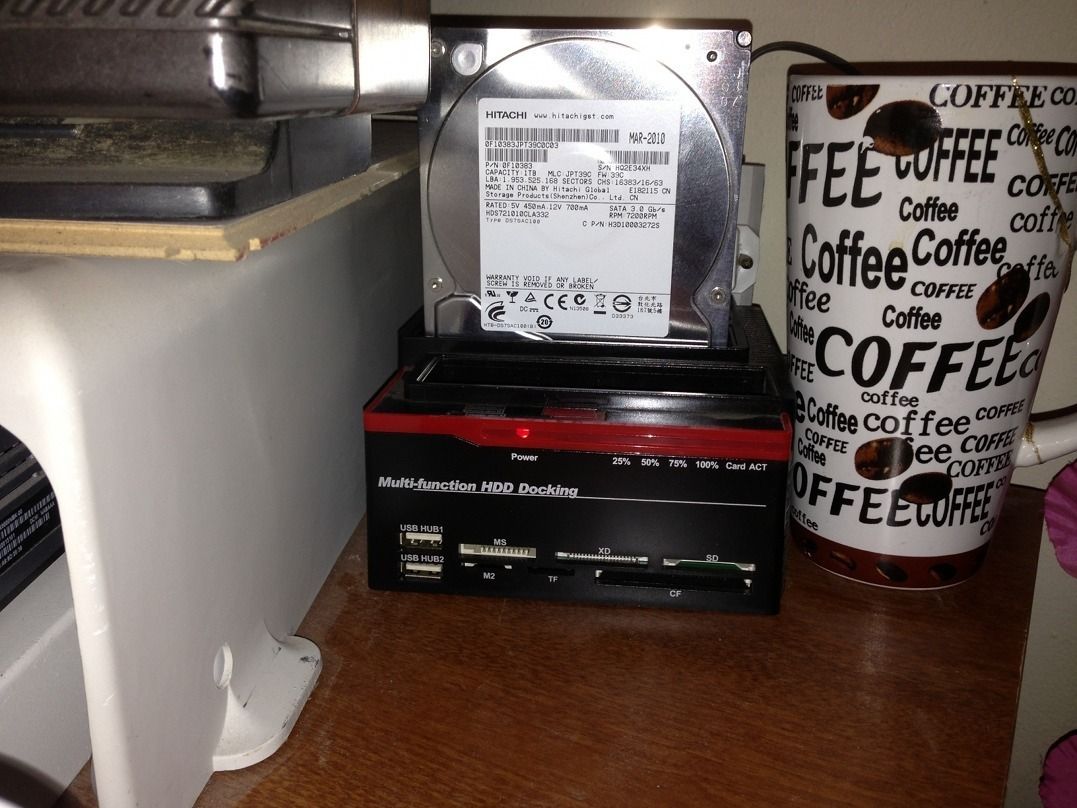

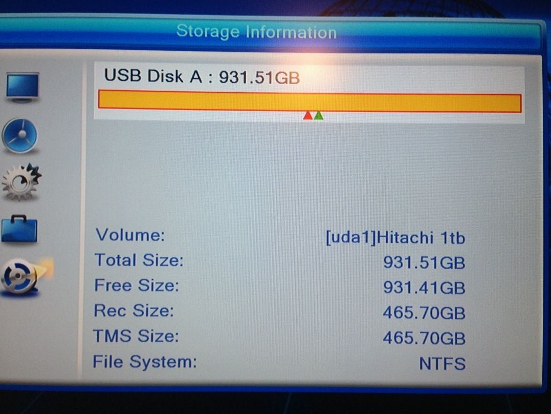

Your described story is my story. Since I had nothing of importance on my external disk anyway, I decided to simply do a quick format via my PC of the external disk. After doing this, the microHD started talking to it again and they've working together like an old married couple. I would conclude that before you disconnect that external disk, always use the disk disconnect menu item in the microHD first.
So I dug through my junk box and I found a USB dock I bought back in January. I couldn't get it to work on the windows PC so I tossed it in the pile.
Then I took a 1tb disk I had removed from my security camera DVR because it kept telling me the disk had errors. I didn't believe that was right but I replaced it anyway.
I stuck the disk in the dock and formatted it on the Mac and it verified error free. I put it on the windows pc and formatted it sloooooow and ran a scan for bad spots and it verified error free there too.
I think that cheap, Chinese camera DVR was at fault, not the disk.
So I removed the stupid old LaCie disks and put the 1tb disk/dock on the tuner and it seems to be quite happy with that. I recorded stuff and it works fine.
What I don't understand is some of the stuff on the information screen.
What is TMS Size? On the old disks it said zero. On the new disk it shows about half of the disk size.
It also says "Record size" and it gives a number that's also about half the size of the disk.. What does this mean?
Also, when I formatted the disk, I googled and found stuff suggesting that for huge video files that you format the disk with 64k size sectors rather than 4k sectors. Could that have anything to do with the numbers that are showing up on the info screen ??

Great to hear that your "new" build is working.
TMS is the amount of space available for time shift recording. Your old unit was not recording as no valid space was available.

Oh ok, cool!
Now here's another dumb question... Can I adjust that TMS number to be much smaller? I have no need for that much time shift.
I'll never really use it that much, at most maybe an hour. Sometimes I'll pause a show then go to the kitchen for awhile or take a shower then come back and resume.
I can then jump through commercials like a boss! :D
I noticed on the top of the screen there is a yellow bar showing how much space is available. It has two little arrows under it, a red and a green one.
I've tried moving them with the remote buttons but no luck. I tried the red and green remote buttons but nothing happens.
I really don't understand what they are showing or how that works..
Am I just missing some simple, obvious thing here? Or do they just really do/mean nothing special?

All questions I've wondered about. I guessed that TMS meant "time shift", but I tell design engineers they've got to allocate more digits for abbreviations/acronyms if they want anybody to understand what they mean. The way the brain works, a better abbreviation with only 3 digits might have been TSh, but TSHFT would have been better still. I've got almost 500GB reserved for TMS! And those little arrows: I want to grab and slide them with a cursor. Is any of this in the manual?
The Timeshift partion size is not a user setting. No idea what the two pointers are in the graphic. Don't think many users ponder over this info screen as this is the first question in 13 months. :D I could turn to ALI engineers, but probably will withhold consultation for operational issues.
A few operational observations:
1.I would not have Timeshift enabled if you are only using as a pause feature. Why have your drives spinning 24/7? Instead, press the record button rather than pause for those few occasions that you step out of the room. Save your drives by letting them spin down when you are not viewing programming.
2. Select PS Record - OFF. This will remove the requirement to select PS/TS at the start of each manual recording. Why the choice of a PS recording over a TS recording is beyond me, but we left it as an option for those who like options and want to tinker.
No additional screen information is available in the manual. It is just the standard display of memory allocation data provided by the chipset. Personally, I never paid much attention other than an occasional check for available space. Not inclined to spend time refining a menu that has little bearing on the STB operation. It provides the available and total disk space information. If you want more refinement, let us know what needs to be done and we will place on the development priorities list.
