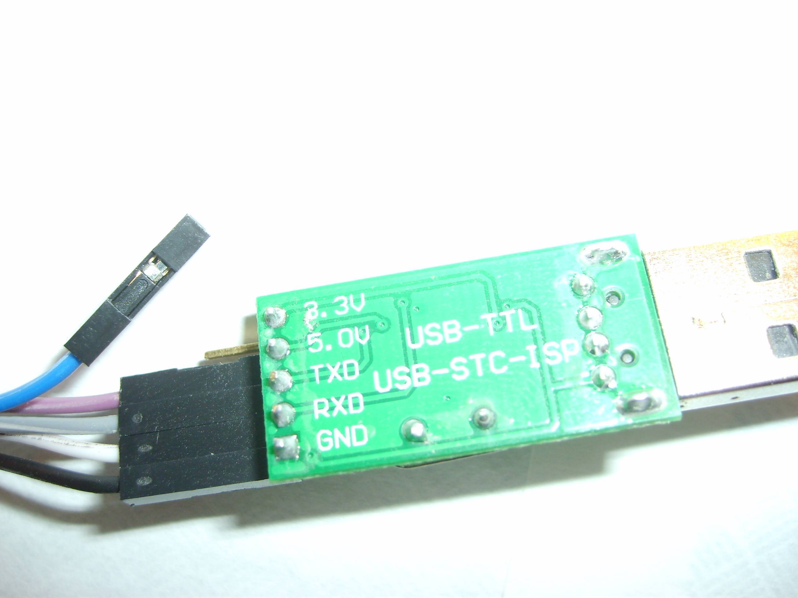

oops...let me just say if you have troubles with the old fashioned cable where you have to connect the pins to each, I have found the labeling on my USB connector has TX and RX reversed :rant:
An hour of trouble could have been saved in 2 minutes.
THANK YOU !!! Apparently mine has the TX and RX pins mislabeled also. I retried again with mine after reading this with the connectors swapped and success!!! I had the LZMA.exe error also but was able to click OK and the program continued.

Which board has the reversed labels? Can you post a picture of it?
On mine, it's the 5-Pin dual voltage (3.3/5) TTL with dual female connector cable. When my microHD went bad the first time, I readjusted things so many times, I didn't pay attention as to whether or not I had the TX and RX reversed. On the back labels, mine reads 3.3v, 5.0v, txd, rxd, gnd.
