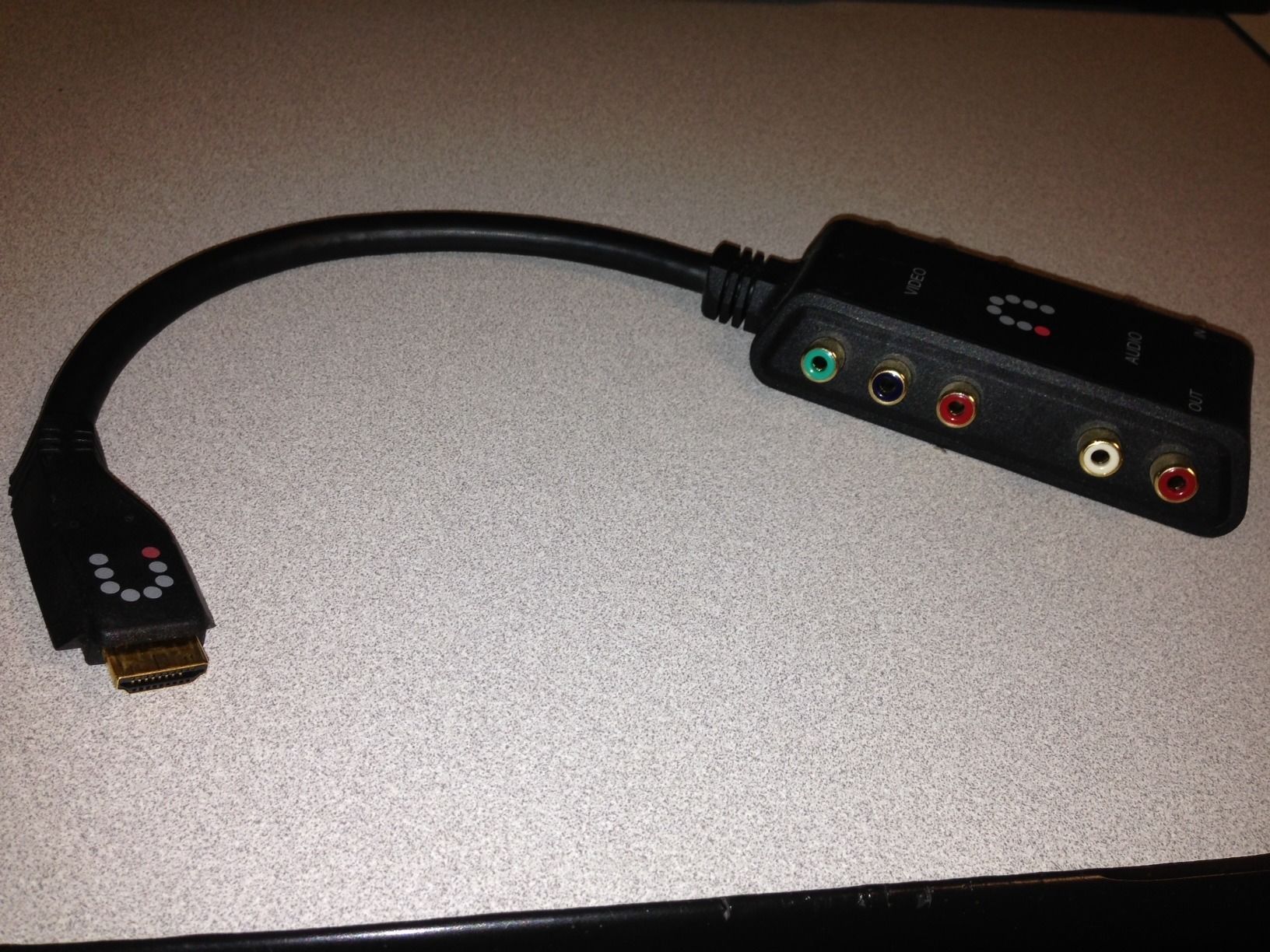

The HDMI protocol does not support analog, but I have observed HDMI ports and cables being used for analog distribution. Example: Slingbox SB200-100 has a HDMI type plug to accept analog audio and component video. The plug is not HDMI compliant and does not accept digital signals.
