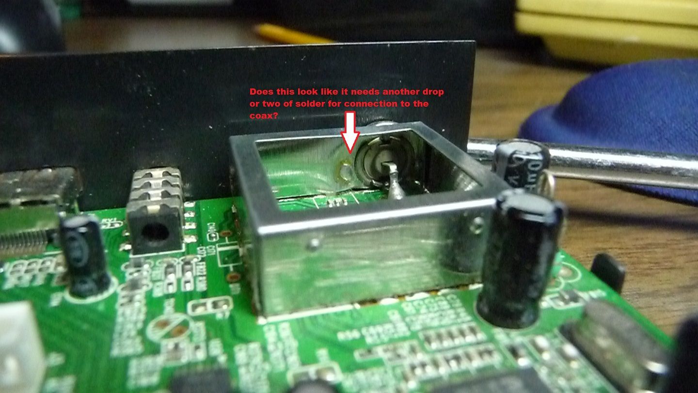

MicroHD sitting here on my desk. I'm no electronics technician, but I can take ANYTHING apart.
. Appears that the coax connection isn't quite solid...maybe it's not making a good connection inside? Hmmm....
I believe there's a current limiting feature built into the microHD, maybe that is interfering with moving the motor. Can you view both H & V transponders? If so I'd say there's nothing wrong with the coax connection in the box.
