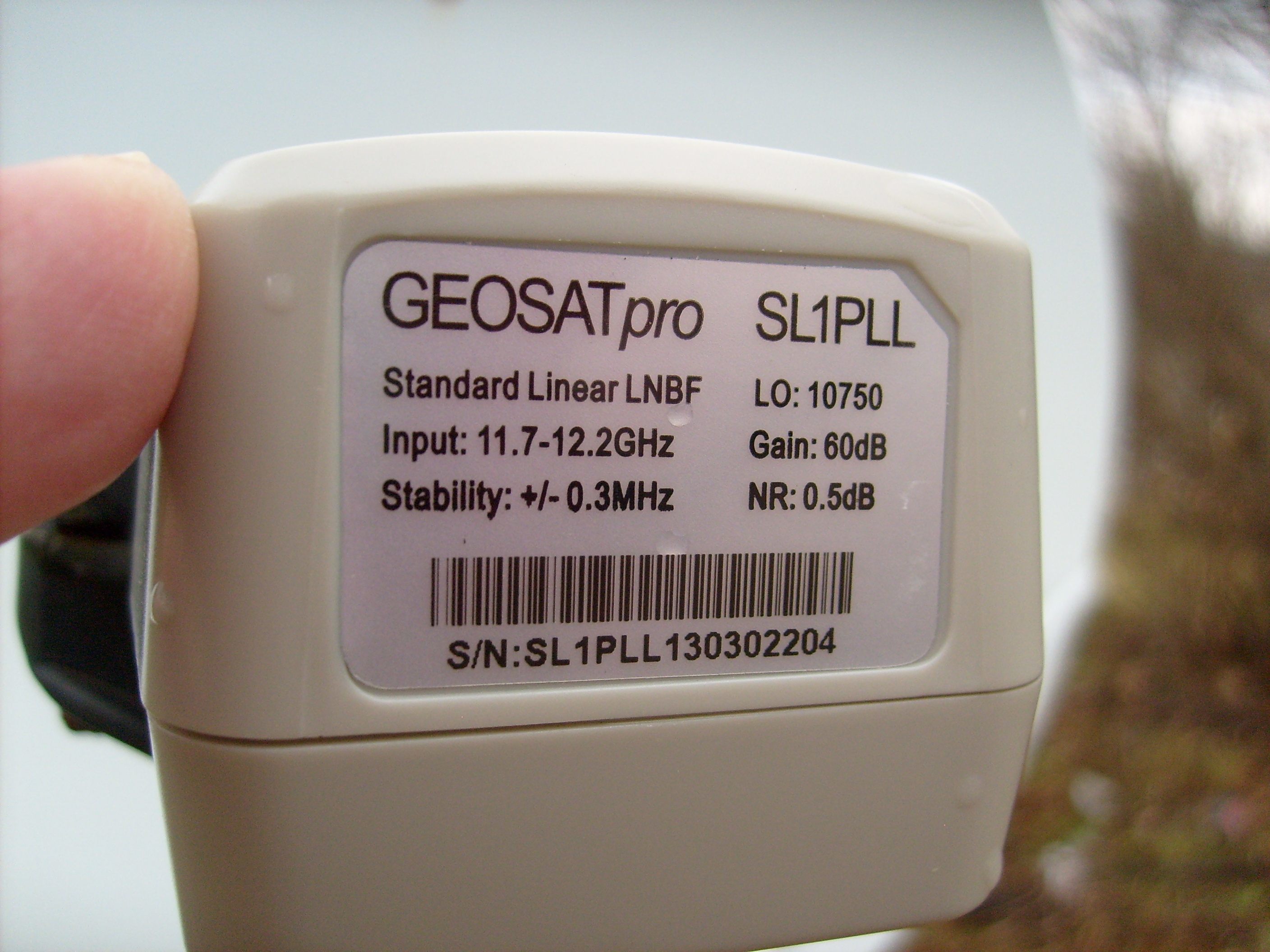

That is the one thats on it now LOL. It came off my 36" geosat pro dish when I got my new duel lnbf. I just took a picture five minutes ago.
When you say 10 degrees, looking at this picture, me standing in front, will I turn it left or right?
