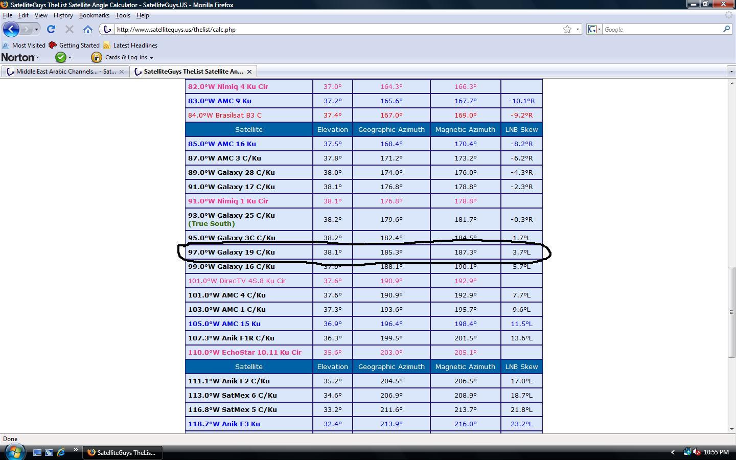

So as an example, I am in Minneapolis, MN which is at 93W so 97W is just a little off dead south. Someone on the East coast will have to aim the dish SW and someone in California would have to aim the dish SE
The best thing to do is check here
Satellite Angle Calculator - SatelliteGuys.US
put in your city/state and find 97W on the list. That will tell you what elevation the dish needs to be and where to aim in the sky
See attached. For Minneapolis my settings for 97 are
38 elevation
187.3 azimuth...so just a little off dead south
+4 skew...with a fixed dish skew is needed.
Try it and see what you get. In the original post you said you were in Virginia but the city or area is not known. I used Roanoke and got the following
43 elevation
215 azimuth (almost straight SW)
+21 skew...this is critical when aiming a fixed dish. You'll want to skew the LNB first
