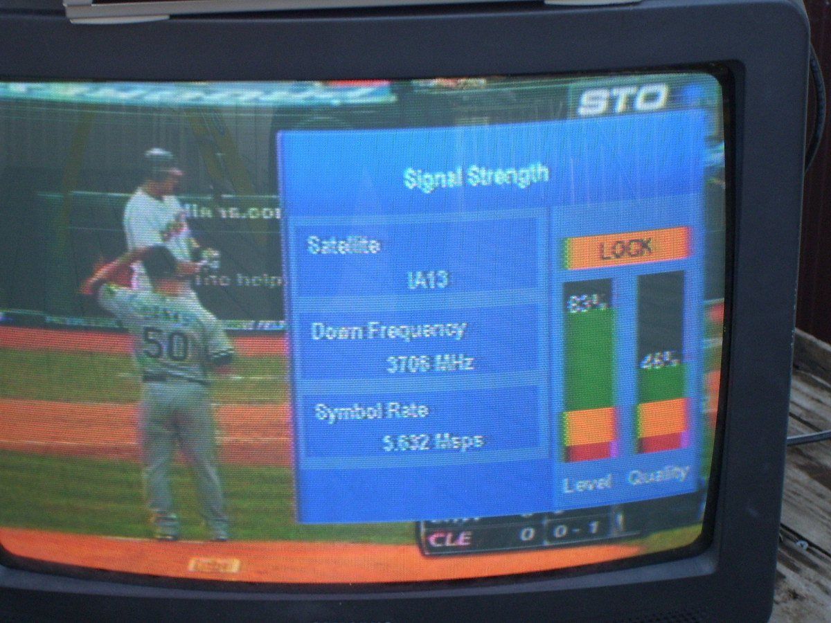

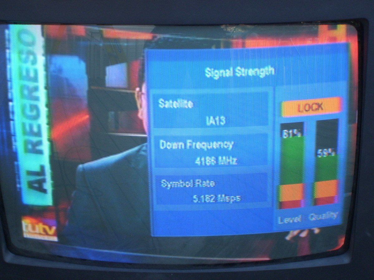

you're right. I can lock this sat with a 40x30 Primestar
STO...45-47 peaks to 57
TVW...30
HITN..60 :eek:

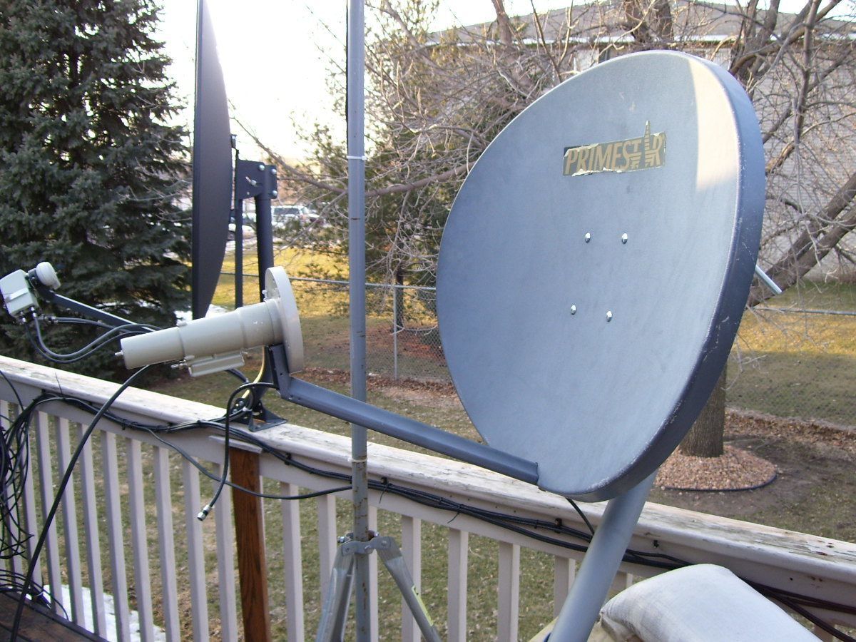

Someone fill me in here....I thought one needed a CONICAL scalar ring to do c-band on an offset dish...Ice, you're just using a regular BSC-621 on that 84e with the stock scalar ring?
A flat ring can work. A concial on a offset is better. I've tried both and get a significant boost in SQ of my conical ring across the board.
yeppers. A conical one helps bring the semi-decent strength channels in. The jerry rig job I'm doing is just for fun and to see if it can be done.
This is the sat I got the most transponders to ping. On 99 I get World Harvest, ABC HD and the 4:2:2 mux there...all around 38-44 quality
What I do is aim the dish at a satellite with KU, remove the KU and slap the C-Band LNB back on and go form there. I have to raise the elevation a little bit to get it to work but it works :)
I don't think it is due to the weight, I have also noticed that I get a slightly better signal with C-band when I increase the dish's elevation (Compared to the location where my Ku band LNB is peaked).
I think it has something to do with using a prime focus LNB and scaler ring on an offset dish.
Is that due to the extra weight of the C-band LNB ?
nah. I think the focal point is off. I don;'t know. When I switched from the KU to the C-Band SportsTime Ohio was at 25-30 quality...jack it up 2 degrees or so and voila...45 steady and peaks of 60
