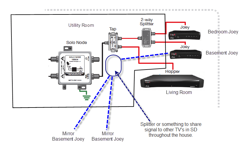

I keep on reading that no other signal can be sent over the same Coax that is bringing the signal from the Hopper to the Joey (very depressing). Can someone please take a look at this image and see if anything is possible? I don't think I can run a second coax from the Joey to my Utility because all my walls/ceilings are drywalled. So I'm wondering if there are any options out there for me to mirror my basement joey to 1 to many TV's in my house. All the COAX ends for the house go to the Utility room, but each room only has a single COAX running to it (each room also has an ethernet cable running to it also if I can do anything with that). With the old 612 I was able to backfeed the 612 output to the Utility room where I then split that signal to any of the TV's in my house that I wanted to mirror what was on the 612. I open to any and all crazy ideas :-)
That diagram doesn't really make sense for your install. If the node and the home runs are all in your utility room then you wouldn't use a tap. The Hopper would be connected to Host port and the Joeys would be split off the Client side of the node. In any case I would agree that your best bet would be to add another joey in the utility room and use a modulator and a splitter to mirror it. Or if you have ethernet home runs, a more expensive way (up front costs at least) would be to move the Joey down to the Utility room and use hdmi to ethernet converters to mirror it that way
