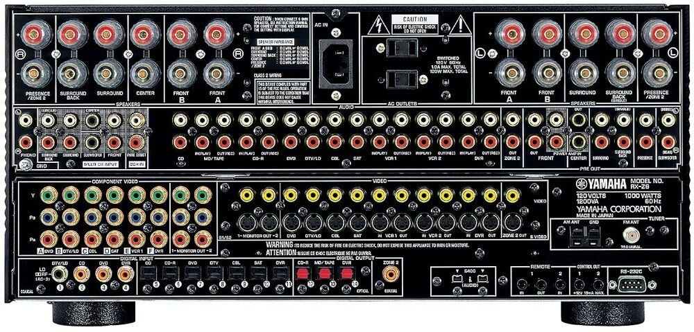

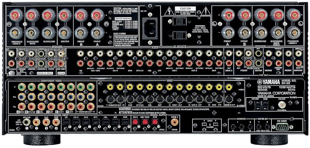

Ok Let me ask you all this. When you have one of these what do you have to do for all of the hookups? Such as your home theater surround and your sat receiver and dvd player. The inputs are limited correct? How do you manage it all?
Connect a single HDMI cable (or component) from your audio receiver and connect everything else to the audio receiver and let it do the switching.
Or, go crazy buying Geffen switchers.
Exactly, to me it is by far the best way to setup, manage, provide a true home theater experience. Here is the back panel of my unit and you can see how everything will go in and your monitor out feeds video to your projector via a single cable; mine is nearly a 37' cable run, all hidden in the ceiling for a true theater look. Better units like this will also be able to take s-video inputs like VHS and output them through the same single component cable running to your projector. I would always recommend making sure you have that feature.
