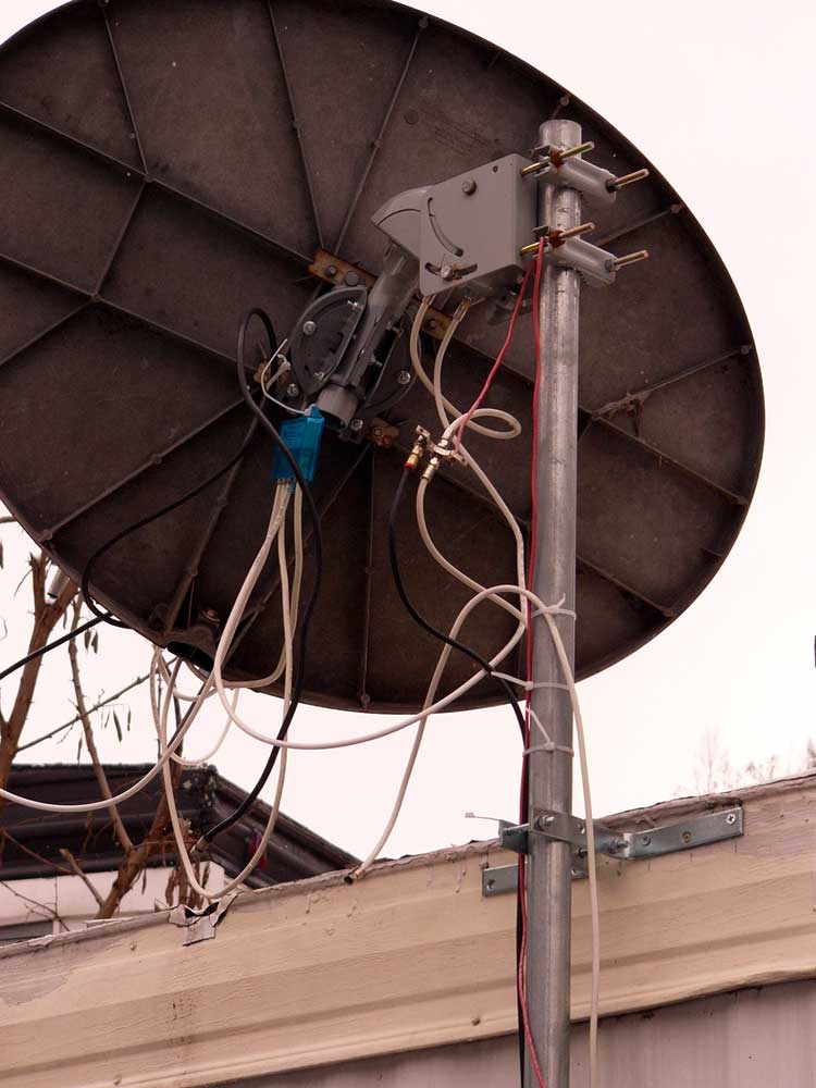

Yeah, gas lines and electrical are major concerns when setting a pole. I'm in a park and my pole is mounted to the side of my trailer sticking about 2' above the roof line. No need to set it in the ground.

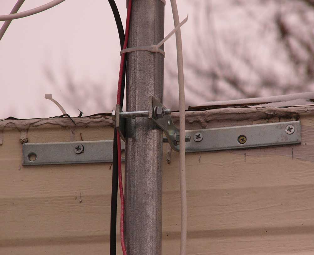

I have a 10' x 2" pipe for my primestar 84e. I bought four of the biggest L-brackets I could find and sandwiched the pipe between two of them bolted together. I attached them at the facia and at the bottom on the rim (floor) joist. It is very solid.
My park had no clause stating anything about dishes, and my park manager usually defers to the city or county codes. Our county has no restrictions on dishes less than 36". I'm a little beyond that at 41" wide, but will claim ignorance if anyone gripes.
I am hoping to put in a six footer some day. The county only regulates setting a pole, and the view of the dish from the street (bushes or fence must be in place an extend past 50% of the dishes height). I was going to put it on a non-penitrating mount and consider it temporary. It will be hidden from the street by my enclosed deck. If people gripe, I will break it down and store it.

Here you go. It's not pretty, but it works well.
Thanks for the Pics, Later will take Pictures of my roof and facial boards, then
someone can give me input.
