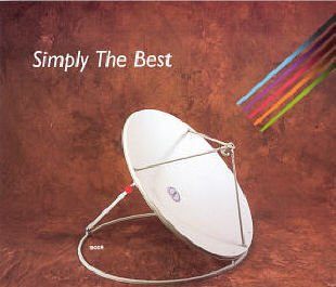

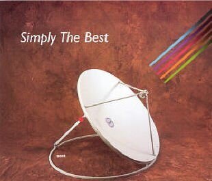

Best option first daveswebshop com Pansat 3 Ft Ku Satellite TVRO Dish $99. Prime focus Ku, ring mounted dish. Provide your own prime lnb.
Looks like this might be a new small prime focus mini bud material. I bookmarked this one immediately
