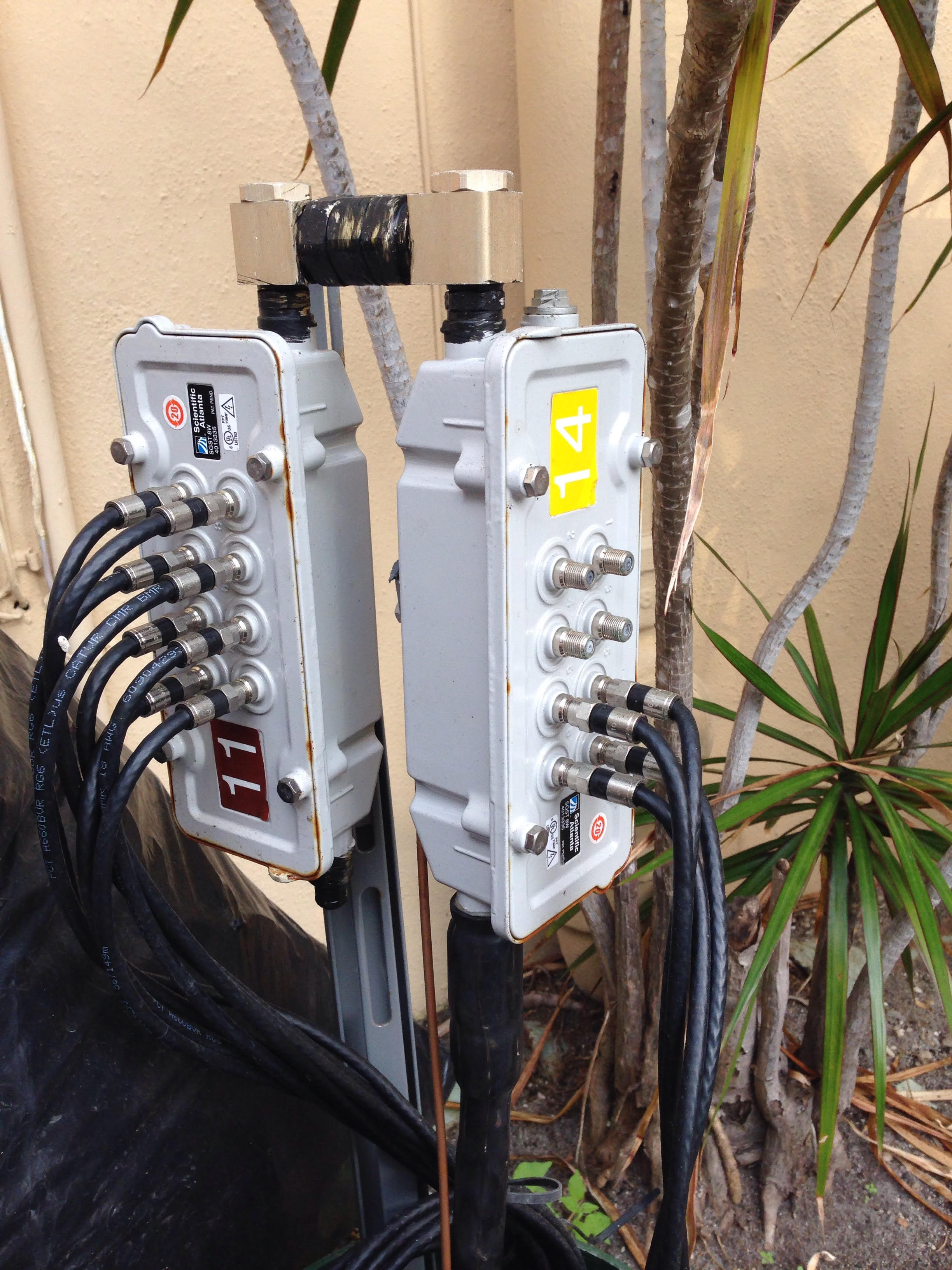

I am placing this here because, quite frankly, there is not really does not fit gracefully under one of the forums and this seems to be the most active Cable Forum where someone might know the answer. Mods can certainly move it if they can come up with a better place for it.
MoCA 2.0 will be used to distribute internet throughout a MDU location via RG6.
I need to place a MoCA POE Filter on the tap to keep the internet feed from entering the MSO system.
However, at the MDU location, the drop is connected to (2) 8 Outlet SA Taps, as can be seen in the photo.
The units are SA (Cisco) SGST 8W Model Number 401 3335.
Clearly, the drop from the street (coming up from the bottom and wrapped in black) is not RG6 - not sure if it is RG11 either as it looks far too large in diameter.
Also no idea if whatever it is has F connectors on it as they are sealed in the plastic. Again, looks larger than normal.
And finally, after googling the specs on this tap, they are only listed to 1Ghz.
1) Will this tap act as a MoCA 2.0 Bridge as the specs are only to 1Ghz and not to 1.625Ghz?
2) How can a MoCA POE Filter be inserted at the TAP entry point?
3) Anyone know what type of cable is in the feed from the street - and what type of connector is used to connect to the Tap?
Thanks
Thanks
1. I don't have the answer to that one.
2. I would recommend individual POE filters on each line instead.
3. The cable coming into the tap is likely 625. It's hard line distribution cable. The fittings used are specialized and not easy to install.
