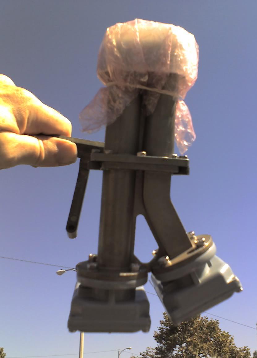

Actually, there are several models of SuperDish, with various configurations of LNBs.
Below, I'm thinking of the model for 121º, with an FSS LNB beside a circular for 119º . . .
Post a few pictures , if you can.
The existing LNB has an oval feedhorn to match the shape of the dish.
Replacing it with a cheapie LNB probably isn't worth the effort.
The dish can be skewed if you are not motorized, so the fixed LNB mount is no drawback.
edit: added picture.
The LNB and horn to the right is 121º, the hardware to the left is 119º circular.
