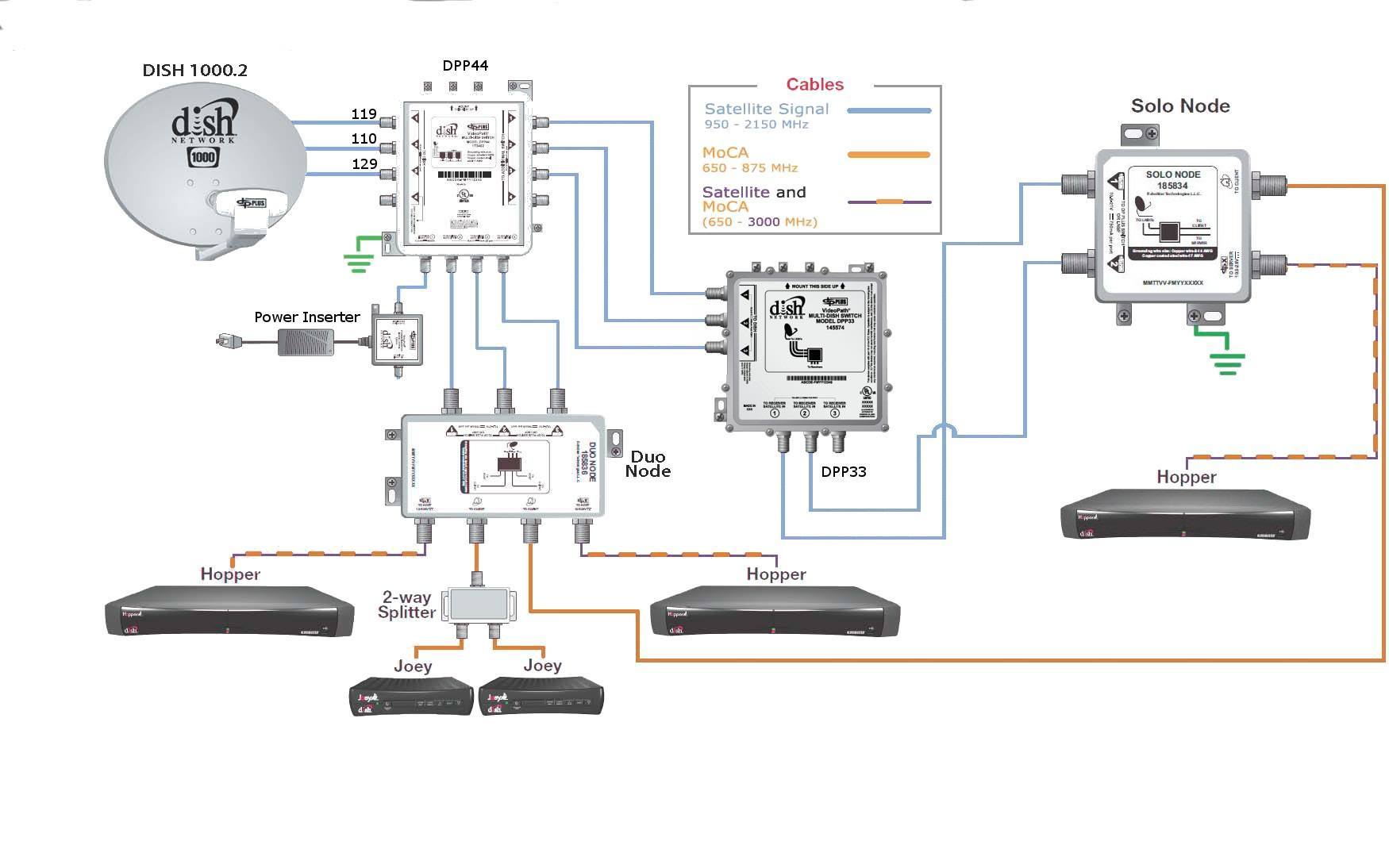

Here it the diagram I would also like to see a picture of this setup installed.
<img src="http://www.satelliteguys.us/attachment.php?attachmentid=85121"/>
That's my diagram :D . What kind of pic would you like?
