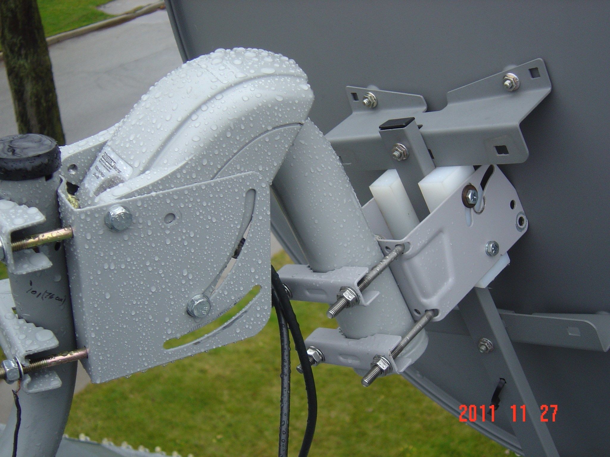

My stab90 died on a 36" dish. dish was stuck on 83w. long time ago i got an sg9120 for half price as a spare. but the shaft is 55mm.
any solutions as to mount this dish (42mm tube) on this motor ?

AS far as I can see there is no way to remove the tube from the shaft. I'm working on a modification to the dish, using the bracket from the old stab 90.

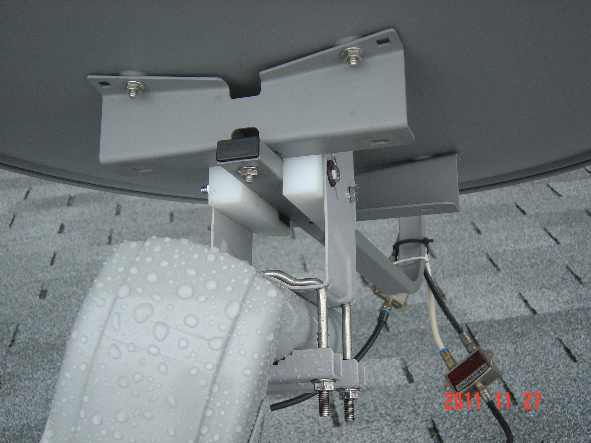

I did it replacing the original bracket with 42 tube (from the dish), with the old mounting bracket from stab90. inserted 2 pcs 1" thick nylon blocks as spacer on each side of the arm and u-bolted the 55 tube from sg9210 to this bracket.
