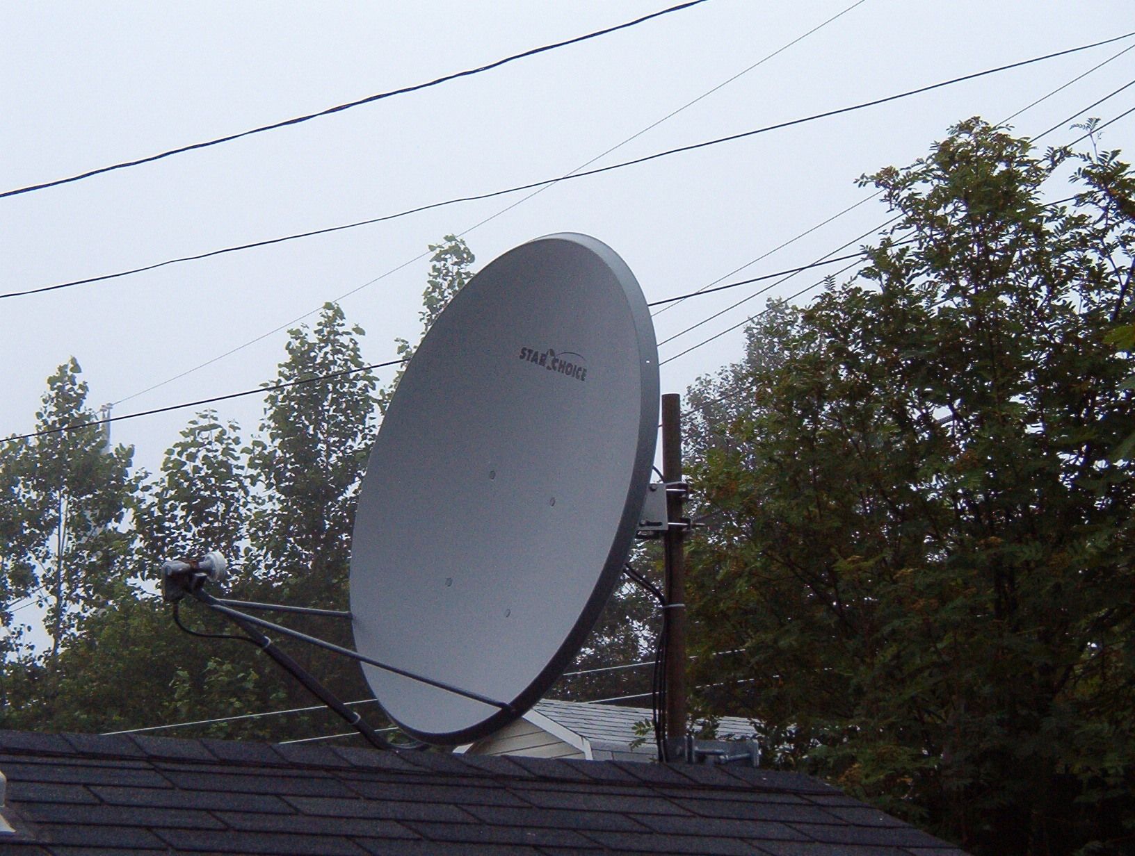

Hey Larry
I have my 1.2M motorized dish mounted on my shed and no issues.
I attached a pic but it is of the 1m dish and have since replaced it with a 1.2M.
The pole is a very heavy 1.75 in and should be 2-3/8 but still no problems.
Good Luck.
Dave

Thanks for the pic! I am still looking at a few possible spots in my yard, but the shed roof I think will get them all :)
