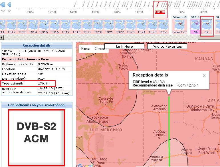

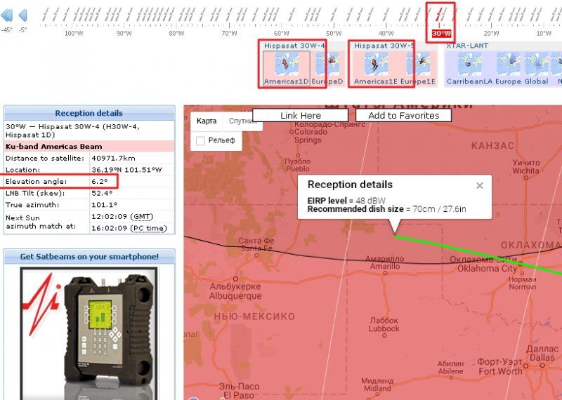

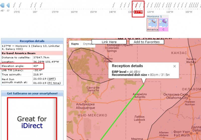

Motor model should support +/-65 degrees in USALS. Tune South 101w.
