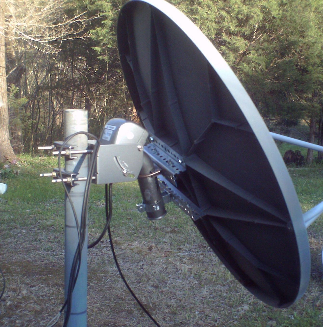

I DID IT!
Finally, I have my DG380 installed and working, only took about 2hours today, after a lot of studying last night. I discarded the 84E Primestar, and went to work on a .90m Primestar I had been using as a fixed dish. (NO I didnt discard it, just took it out of the equation-I'll use it for something else!).
With some bracket metal and muffler clamps, conduit hangers , bolts and a hacksaw, I had it working fairly well. Getting that declination adjustment built-in was the only slow-down, but I didn't need much declination anyway. I can get the weak shopping channel on AMC6, and WhiteSprings too, I'm glad it's done, except for some minor tweaking of the tracking. *Can't get all the tps on AMC1 ku, but I can get RTN. Can't get the 'news channel' on 93-you know the one-but I can get it outside on the test rig. Which means I lose something in the 100' or so of cable. Going for new cable tomorrow, the local Marvins Building Supply had sold out. But they didn't sell spools, only by the foot, AT 39CENTS A FOOT.
Sorry for the crummy photo , I was moving the camera it appears. That's a 2 1/4" muffler clamp on the top holding the dish to the tube, and a 2" conduit hanger at the bottom for the dec adjustment. Seems to be gripping tight, which was the problem with my first attempt with the elliptical dish and primestar mount-upside-down.
Many thanks for the help, everybody, and for posting those pics that gave me the solution to building my own bracket!

Thanks Starman! If it hadn't been for the wealth of ideas others have posted here, I doubt I would've ever thought of it.
Nice looking setup, turbo, glad you got it going. I think you'll really like that 380 once you get it tweaked in totally.
When I setup my 3ABN .9m and 380 it was so easy I couldn't believe it, that was the first time I ever set one up and it's going on a year now, hasn't been touched.
Yep I find its a little weak on some sats, and one polarity or the other on other sats. Hard to figure out just yet, but I will. Seems to be peaked at AMC16, which is good because it is nearest my true south, the color bars are screaming there. But strength seems to fall off by 97 or 99 going west. So I'm almost done with it, I hope.
I wonder too lol. Thanks Sadoun, that is one tough motor. The next one should be cake since this one took me a week to aim ! Weather wasn't good for most of that time though. You should add "quiet as a mouse" to your adverts for the DG380. I was about 15' away with my test setup, and could barely hear it, in fact I had to turn sev times and be sure it was actually moving ,haha.
Great suggestion. It happened to me the other day. I was moving the 120cm dish outside of our showroom using the button on the DG380 and the thing was so quit, I was wondering if it was moving. The dish was indeed moving, but I was pleasantly surprised how quite it was. I have not touched the motor outside for over a year. It takes a licking and keeps on ticking. :)
