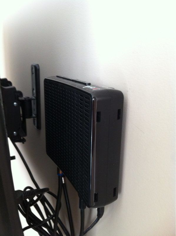

I have wall mounted two joeys used all the supplied dish bracket an wall anchors and screws with no real problem. The only oops I ran into was I had to rotate the bracket a few times to find up.

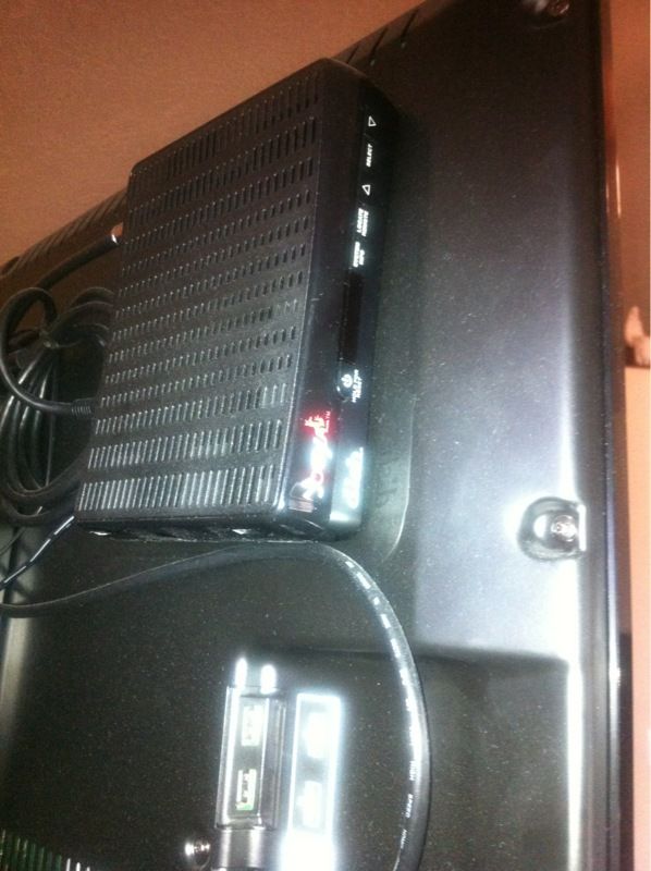

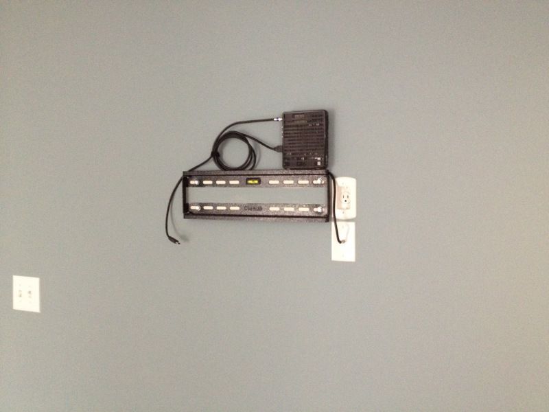

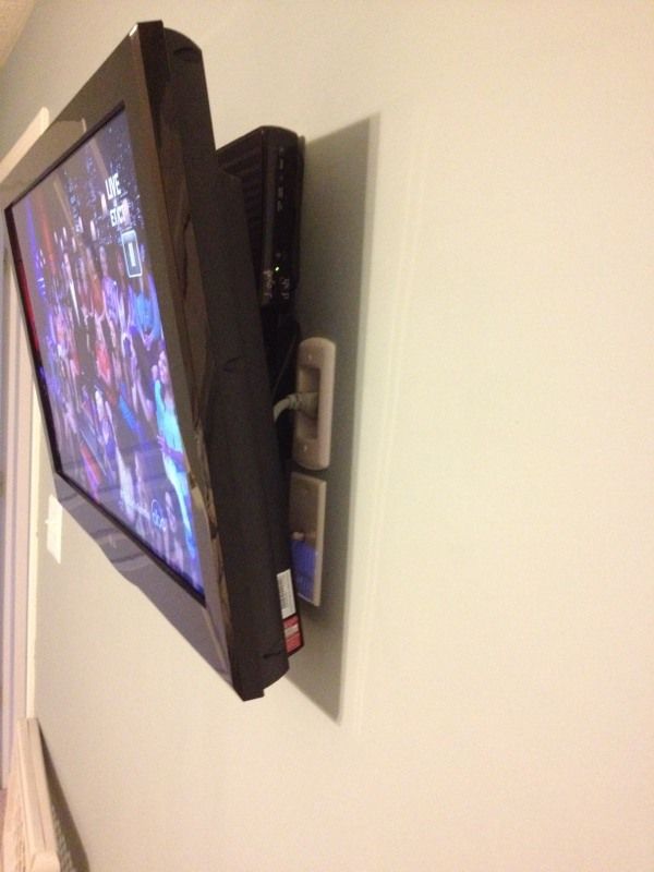

We just painted, so I have recent pictures of our bedroom setup. 32" LCD with quite a bit of tilt so we can see from bed.

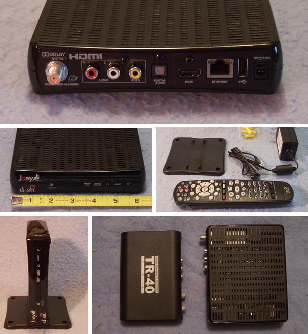

The Joey comes with a stand that can either mount to the Joey horizontally or vertically. It also has screw holes for wall mounting.
Here's a picture of the Joey along with it's accessories (including the stand) :-
(Ignore the TR-40)
