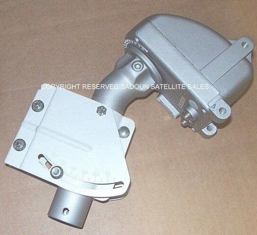

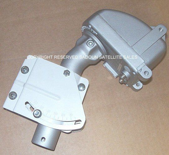

I got my motorized FTA system from Sadoun the other day and spent a lot of time yesterday trying to see how the Fortec 90cm dish should be mounted on the DG280 motor shaft. I didn't readily see where the holes are on the dish mount to go through the holes on the motor shaft. Can someone guide me please? Your help will be greatly appreciated.
See attached picture for a similar setup:
will try again
Thanks Sadoun for posting a sample picture of how the dish is attached to the motor. I will give this a try and see if this resolves my problem. My number one problem right now is not the motor, but installing a new mount. The one that came with my FTA package does not allow enough room for the 90cm dish to clear the roof when being rotated. I found that out as I placed the dish in front of the motor, holding it in my hands, and "simulating" the movement of the dish. I put this mount on the end boards that meet at the edge of the roof (a common place for dishes to be mounted). After all that work of carefully making sure the mast is plumb both horizontally and vertically, I'm going to leave the original mount there and possibly use it as a place to park my XM radio antenna or a much smaller OTA antenna.
