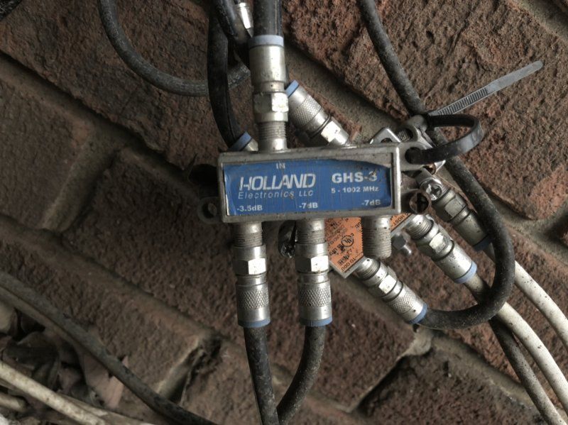

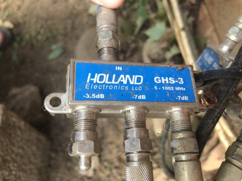

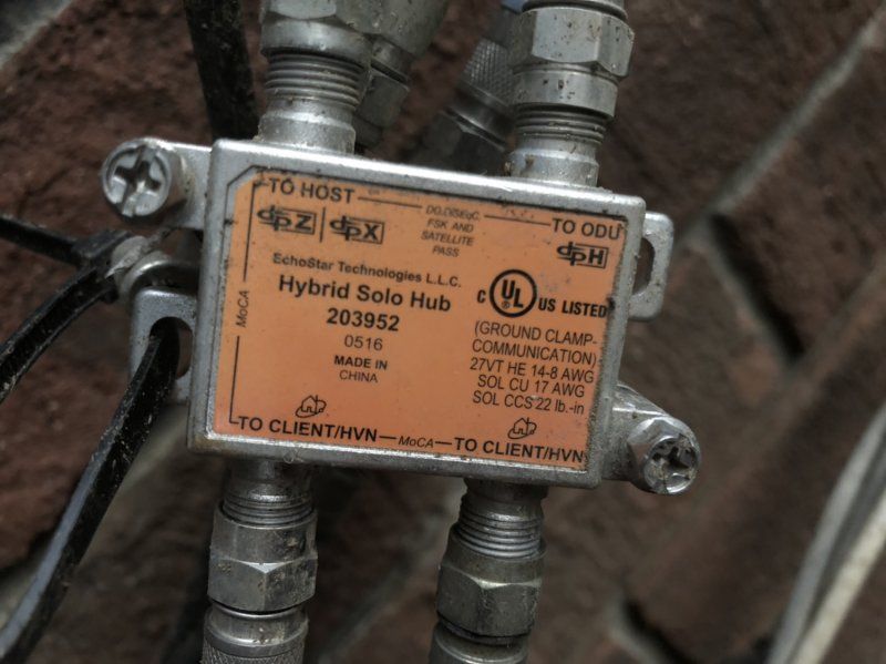

So I need to make sure I understand the configuration.
On the orange hub. It looks like the "To ODU" goes to the dish? And I assume the "To Host" goes to hopper? And each "To Client" cable goes to a blue hub per cable.
And I assume the joeys go to "-3.5db" and "-7db" accordingly? What is the difference between those 2 ports?
The signal strength out of the 3.5dB port is less than half of the original signal and out of the 7dB port is less than one quarter of the original.
I don't think that's exactly right. It's not cutting signal strength in half, it's cutting dBM's in half, right?
