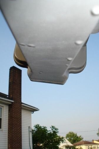

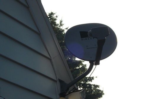

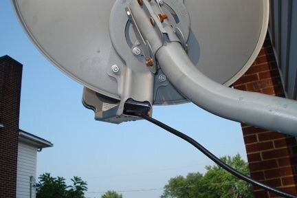

Here are some pictures of the setup
I attached some pictures of where the dish is pointing. Let me know.

He isn't running a separate multiswitch, just the one built into the lnb assembly.
The site is doing maintenance so I can't look at the larger pictures. But, the thumbnails don't look like there is enough tilt for your location. I just tried the full size images. I still don't think there's enough tilt.
