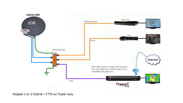

When the Joey my son was using began to malfunction he moved the Super Joey from the guest room (not sure why the tech put it there in the first place) to his room but now it's tuners are not receiving a signal. We understand that it has to do with the way the cables are connected to the hub but I'd rather not mess with that at all. I've also did a bit of research and even if I did move the connections around it would affect the internet connectivity between the receivers. I did take a look at it and traced the wiring. Referencing the attached image, the Hopper in Living Room is on the bottom, my son's room is on the middle labeled Client, and the guest room is on the upper connection but no receiver is currently connected. How can I remedy this without depriving my son of TV?
Put it back the way it was. As you can see in the picture, it's cabled in a specific way. Dish isn't like a cable company that sends signal through out out the house and uses splitters, etc. The Hopper system can only be cabled in a specific way and he probably put the Super Joey in your guest room because of the cabling. Super Joeys cannot run off of splitters like Joeys can, or use RG59 cable. Regardless, why does it matter? All the receivers have the same functionality because the Hopper runs the show. The Super Joey and Joeys are no more than a monitor on a computer, just showing you what the computer is doing. The Joeys are just showing you what the Hooper is doing at that location. The Super Joey just adds 2 more tuners. No matter where you put the Super Joey, or Joeys, it doesn't give you any benefit other than aesthetics - some people lie to see the biggest box on their main TV, for example.

Swap the guest room and the client room cables on the outside and it will go back to working.The 2 outside ports on this switch lets power pass from rec to lnb the center does not and the super joey puts out power to the lnb and this will not affect your connectivity on the rec

I'm not certain that I want to do that. On a support post over at Dish main site it said moving the cables can mess with MoCa, which is how the secondary receivers connect to the Hopper for internet.

I wouldn't suggest telling somebody to change the connections without knowing the cable situation. He may have put the Joey in the sons bedroom because there are splitters in the wall or something like that which he couldn't get to and since the Joey's work off of splitters, that would be the more sensible place to put it.

Seriously, though...if you can easily get to your hub, I think your best bet would be to at least try to swap the Super Joey and Joey connections, and retry the Super Joey. I would power down all of the receivers before making the swap, swap the connections, then fire back up the Hopper first, followed by the Super Joey, then the regular Joey...and see if everything starts working normally again. If not, you aren't out much time and can swap the connections back to their original locations before calling Dish for a service call.

I disagree. This stuff isn't rocket science. He can make the swap, if it works great. If not swap the cable back.
