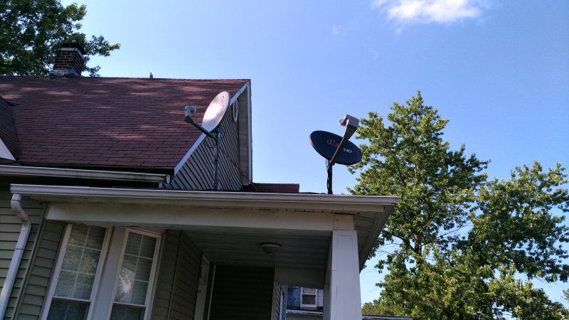

I work for a sub, one of the largest subs Dish has, btw, not Dish In House, so it's not all contractors, although you nay have a bad one in that area. Here's a Hopper 3 job in a market for WA HD locals where I only had LOS for the 129 so I had to wing dish that in with an EA Hybrid
