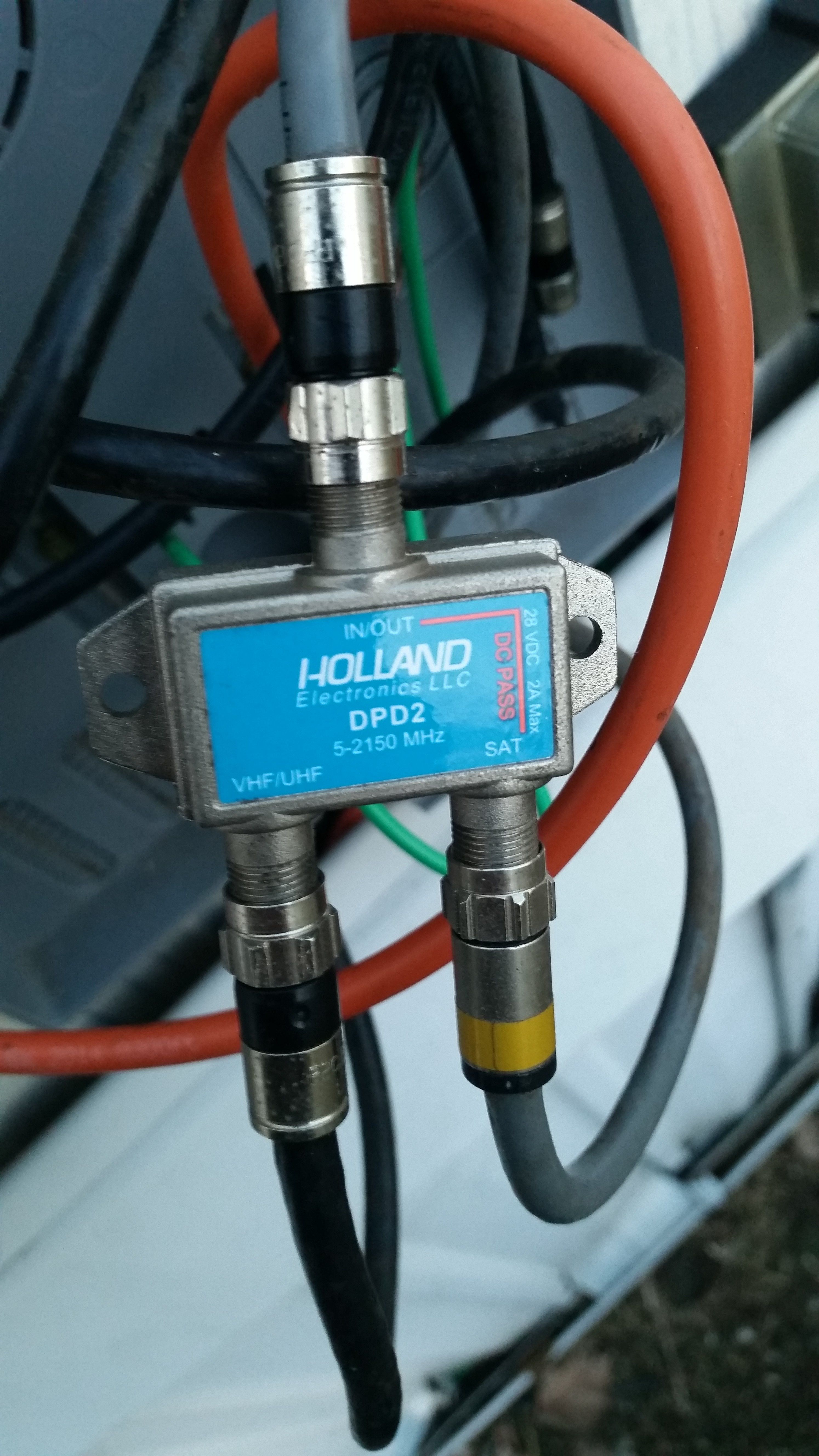

a couple of photos would be helpfull if you can add them shing your cable connections and splitters

The two cables that don't have the yellow band should be swapped. The cable with the yellow band is the satellite feed and needs to be left alone.
