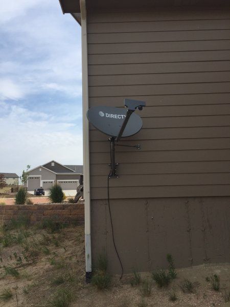

Can anyone ID my dish and LNB? I was wondering if it matters which dish/SWM I buy for the cabin? (I don't have a 4K TV there right now. I might down the road.)
Thanks for all the replies. You folks are very helpful.
Well, I can give you the basics, its a SWM SL 3 or 5
If you go to the Menu/ Settings / Info and Test / Genie Info and scroll down it will tell you if its a 3 or a 5 (majority are 3)
If you want 4k make it a SWM SL 3RB ...
Some of the other may be able to give you the actual model numbers.
Don't forget, you'll also want a Power Insertor for the cabin as well, unless you get one that is built in.
Yes, I have already planned to buy a power inserter and a 4 port splitter. I can add a DECA later if I get broadband.
