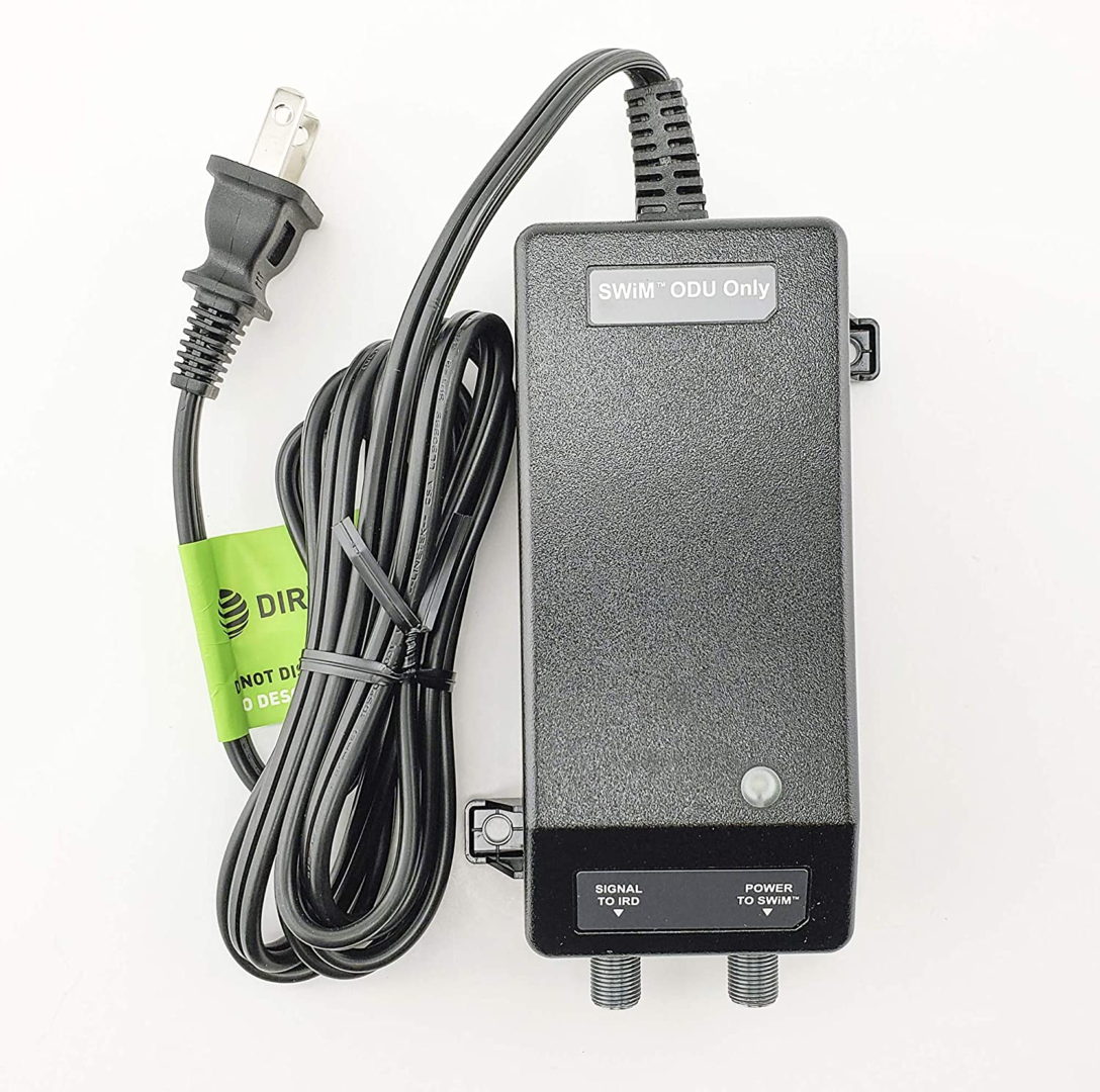

That depends on whether or not the HR54 is powering your antenna. If there's something that looks like this on the second floor (or perhaps elsewhere), you're good to go:

The HR54 has it's own power supply. But not everyone uses it. But if this was a recent install, there is no external Power inserter involved. If there is just a 2-way splitter, as long as you keep the HR54 on the red port (the one that passes power to the SWM LNB, there should be no problem swapping the HR54 and the C61K mini. If you get it backwards, there is no harm, you just won't get any signal, because the LNB on the dish won't get any power. On any DirecTV green label splitter, only port 1 (the red one) passes power to the incoming port on the other side. The rest are blocked for DC to keep multiple power sources from burning each other out.

Yep, the 4k mini genie is going to the second floor. Believe the H54 is self powered, since there's no power supply like that.
