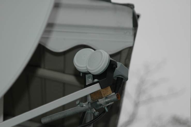

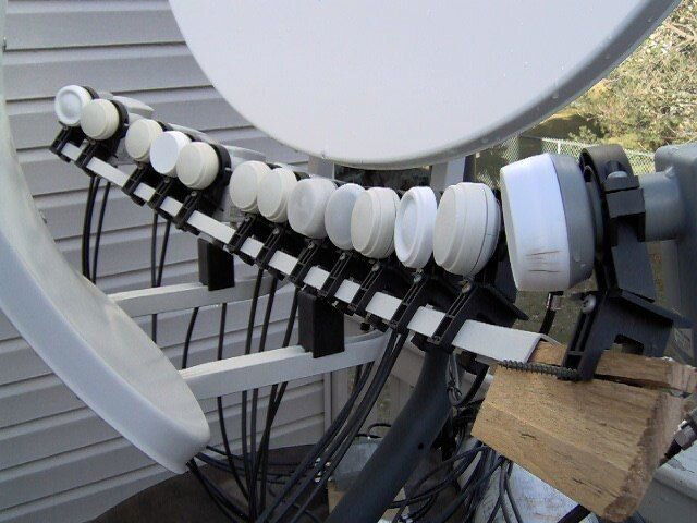

When working with multiple LNB's they go backwards on the dish compared to their actual location due to the reflection off the dish
Case in point is the below picture...the main LNB (the farther one away) is at G10 (123W) and the closer one is at 119...
In the clarke belt the 119 LNB would be farther away but since we are working with multiple LNB's, they go opposite

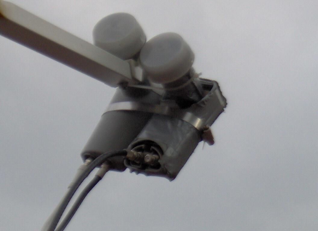

or in the case of the T90...sure they are aimed at the 2nd reflector but the setup is the same
closest is 119...farthest is 72
but in the clarke belt they are opposite (72 would be the closest)

Below is a photo when I had 97 and 101 on the same dish. As in Iceberg's photo, to get satellites 4 degrees apart one LNB (101) had to be slightly behind the other LNB (which then partially blocks it causing some signal reduction). I remember it as being a pain to aim and get the highest possible signal (much tweaking). Due to the larger number of transponders on G25 (97), you don't want to put the 101 LNB in front of 97! Good luck.

Iceberg that is an amazing picture lol. Are you sure some kind of permit isn't required to own that many lnbfs? One question I've wanted to ask about these toroidal things is--Wouldnt it be cheaper to just buy one lnb and a motor, for what all those lnbfs cost? Or is it just because its a cool dish?
instant channel change ( no waiting on motors) and plus you can add you subscription dish to this (toroidal) so it cuts down on the # of dishes plus if you motor over to g10 you can't have someone else watch a sub over at 119 or say your pvr is set to record a game over at amc3 .... so there are several advantages to having a toroidal... i would love one but i'm pacing myself you know with the addiction and all :D
Just to add to what George said, I also use 4x4 Multi-Switches (so you need dual lnbf's) so the Torodial can be used with multiple receivers (up tp 4), and like George says, any receiver can watch any of the lnbf's.
original reason was to combine my Dish subscription, StarChoice subscription and a couple KU LNB's onto one dish (which eliminated 4 dishes at the time)
Also as noted above, hook up some 4x4 multiswitches and you can have multiple receivers on different satellites :)
(works really good during sports seasons)
But the main drawbacks are only 40 degree spread and its 3 degree spacing between LNB's so you have to go like
85,89,93,97 or 83,87,91,95 etc

nope that wasn't me. I just was able to jam 2 LNB's next to each other for 91/93 & 72/74
But there are other ways ;)
