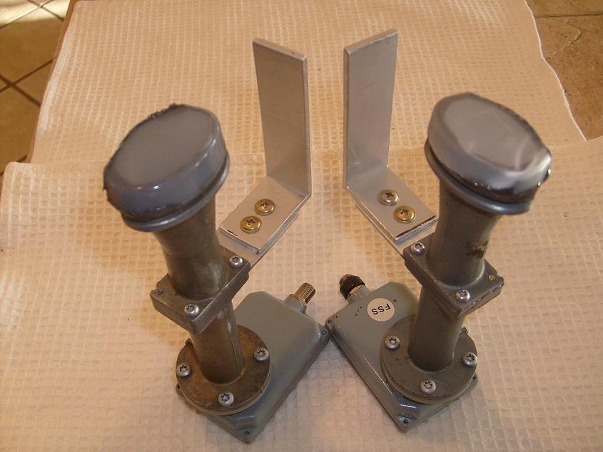

As for the 119/121 LNB horn assembly, each has a different sized horn.
It had crossed my mind to run a band saw between the two pipes.
Not sure if there's enough meat to do that or not.
Then, you could use two of the 121 horns and pipes side by side, spaced as necessary.
I suspect... that the 119 horn and pipe is set up for circular and would need reaming to do linear, even if a FSS (linear) LNB could be mounted to it.
So, I wasn't betting the farm on that 119 hardware. :rolleyes:
There is enough meat, you linked my pictures in this thread of the 121 halves I built (installed). Attached is a picture just before install.
