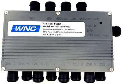

My first multi switch was a Zinwell, and while it worked, it would do flaky stuff at times. Seemed like bleed over to me from another port. I tried a WNC 4x8 did the voltage mod and all has been fine for years now. I now have two spares that I have pickup up, but have never needed them. I run a Chaparral C-band ortho on the 10 footer, and the original Andrews feed with a ortho on the 1 meter. TBS 5927 on one PC, 5520 on another and a V8.

Neither switch is powered. The Atras 3x8 switch that is now working (mostly) has a port to add optional power... but it didn't come with the power injector.
I'm hoping the get the switching to work at the dish. I'd rather run 3 coaxes 170 ft than 5 or 6 @ 170 ft.
My Diseqc switches worked fine out there.

My WNC switch was out at the dish, and powered through a spare coax, and worked flawlessly. I still have the switch, I'm just not using it right now for a different setup. I would NEVER try to use an unpowered switch with a 170ft run. IMO, that's too far, and it's doubtful your receiver has enough current to run it that far all by itself.

Many to choose from, just make sure it comes with the power inserter.

I looked at the link for the WNC model above. It says:
"The AC/DC Module is designed for connection to the 4x8 Multi-Switch directly, or remotely via a commonly
available RG-6 cable, up to I 00 feet."
Would that powered switch work over 170 ft away at the dish?

It's more likely to work with it's own power inserter, than just trying to power it from the receiver alone. Don't forget your receiver also needs to power the lnbs at the same time, and any other diseqc or other switches you may have in line.

Folks, the reason I recommend the WNC switch is because it is not potted, easy to do the voltage mod on. Keep it close to your receivers, close to the house so your receiver can control it. it has plenty of power once it gets it's instructions to power the LNB's
