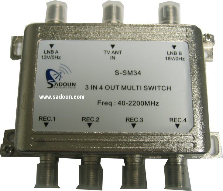

Here are some multiswitches
3x4...most common on the 18" dishes to run up to 4 lines...I use one of these for my setup...3rd port is for a OTA antenna

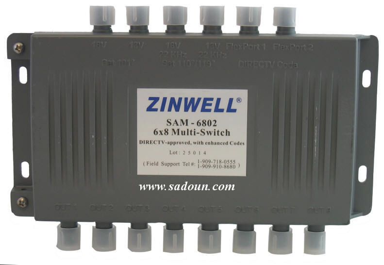

4x4..most common for the old Phase II units that had just 101 & 119. Not really anymore since the Phase III has 4 outputs. You do use a 4x8 if you need more than 4 outputs

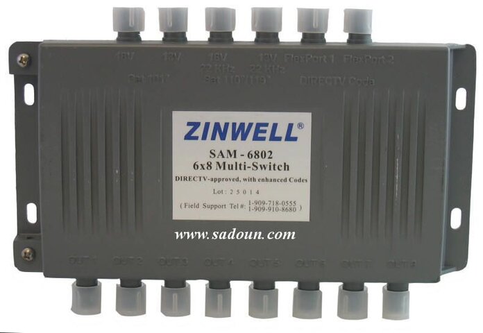

6x8...the one you use on the old slimlines if you need more than 4 outputs.
