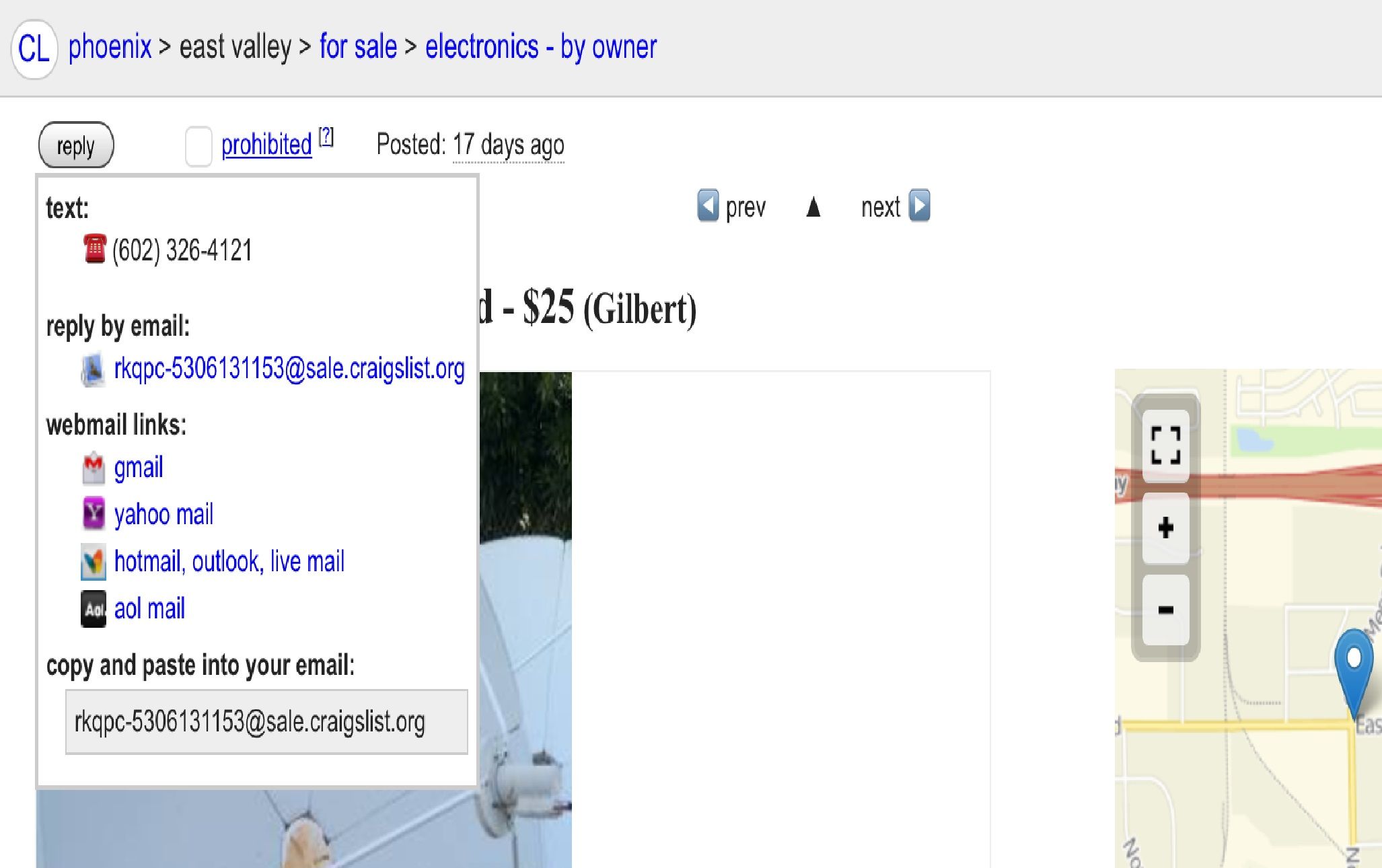

The man I bought the dish from was also selling new ones on ebay for $100 plus shipping. I can't find his Craigslist post or his ebay post. The Craigslist post was there a few days ago.
I have attached a screen grab that I had made of his Craigslist post last November.

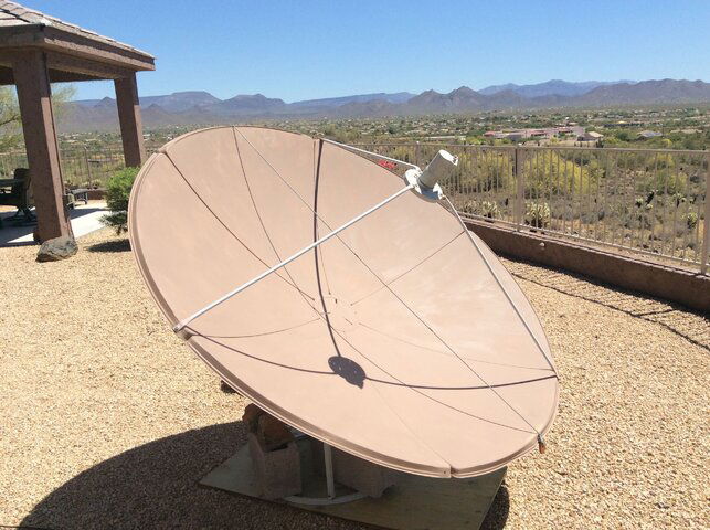

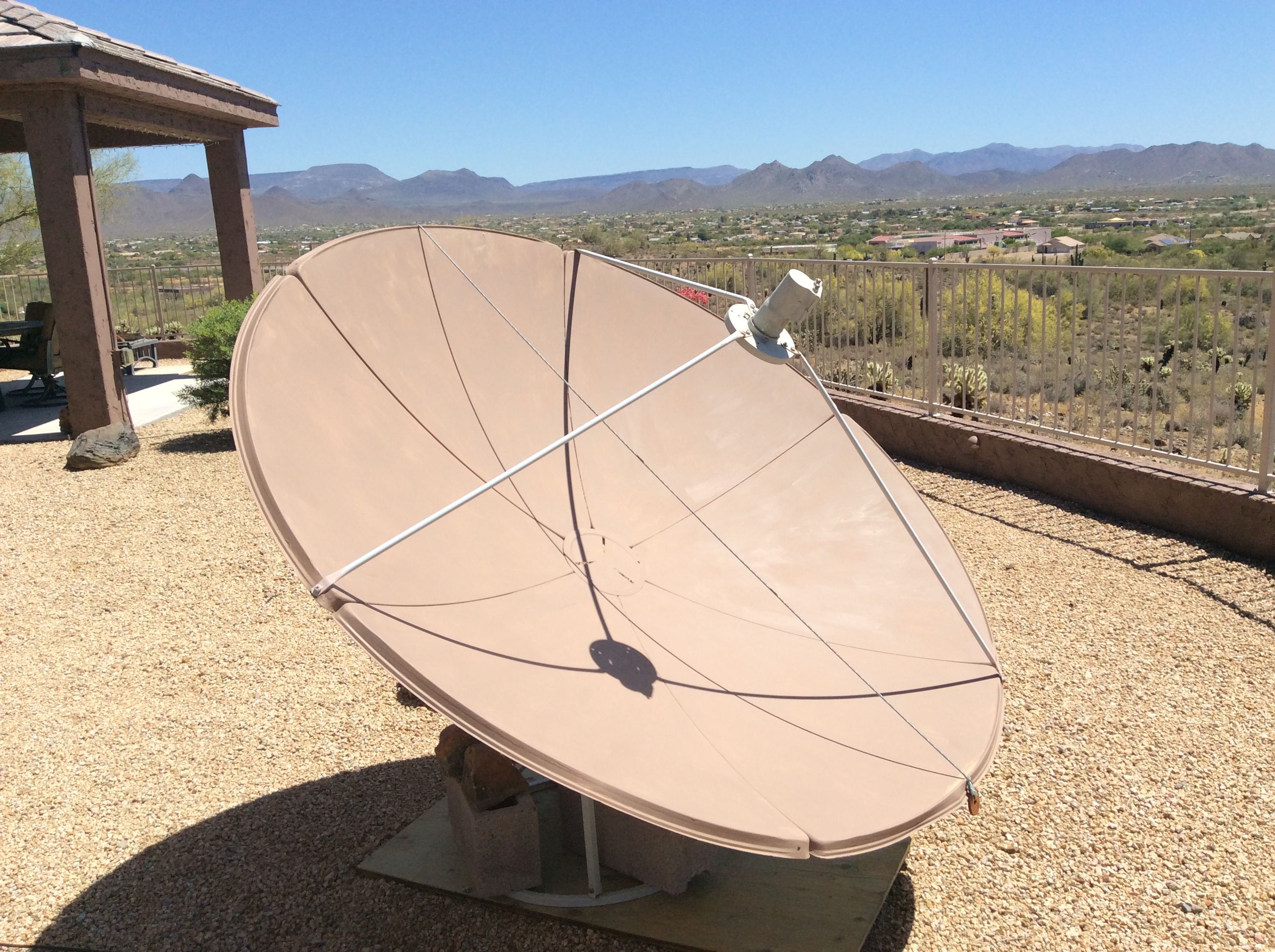

Al K,
Congrats on the dish and thanks for the photo. This is the first 6 footer I have seen with that circular mount. Some years ago I fooled with a 6 footer and was looking for one of those circular mounts but none were to be had. Your picture has been very helpful in actually seeing how a dish can be mounted this way. Good luck with your dish and thanks for posting.
Years ago I had a Fortec six footer like that and put a HH style motor on it. I believe it might have been a CM160? Actually worked pretty well.
