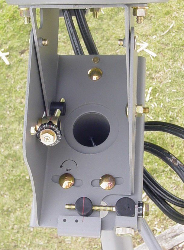

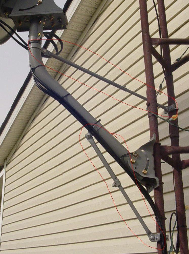

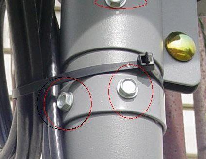

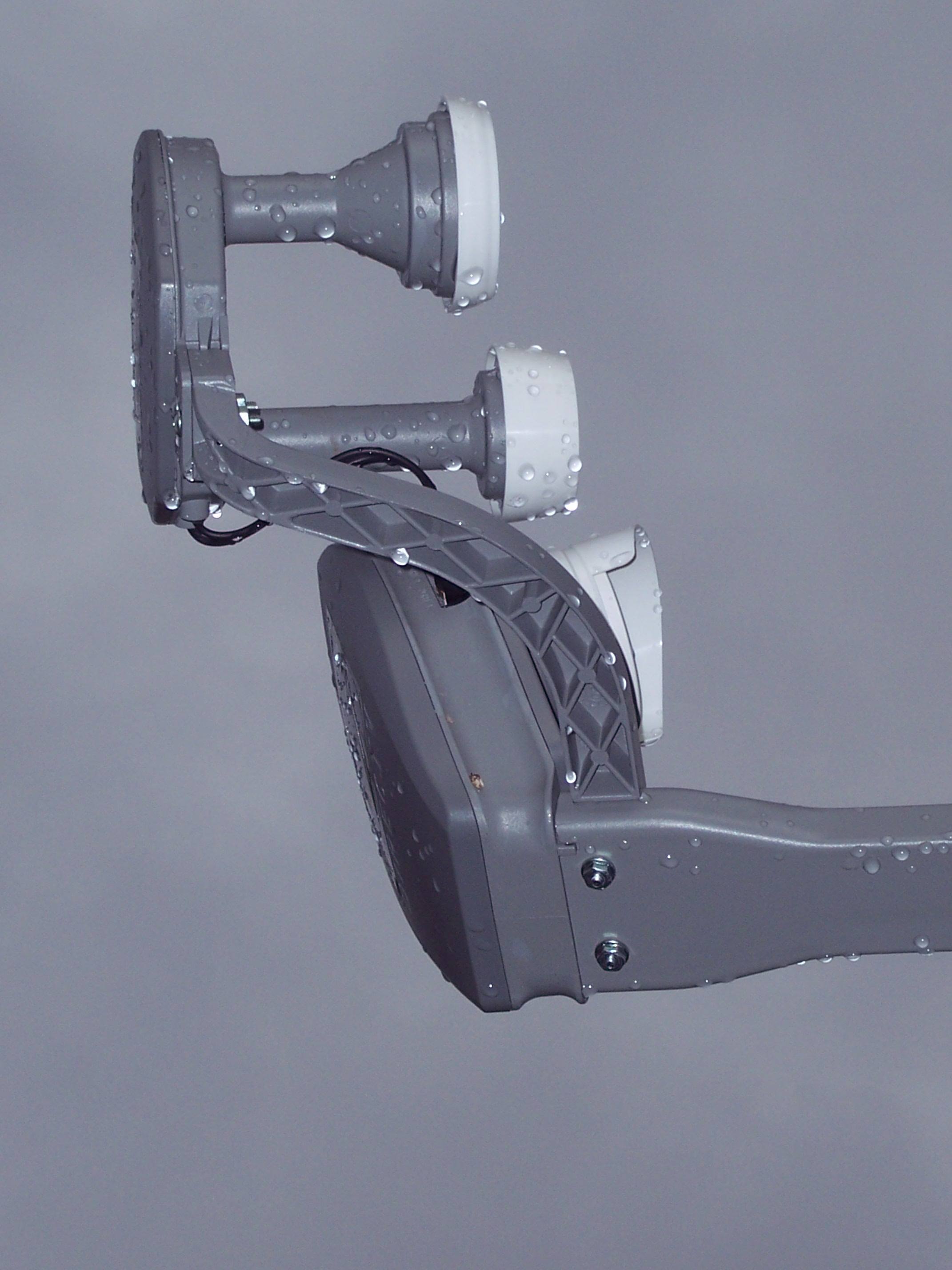

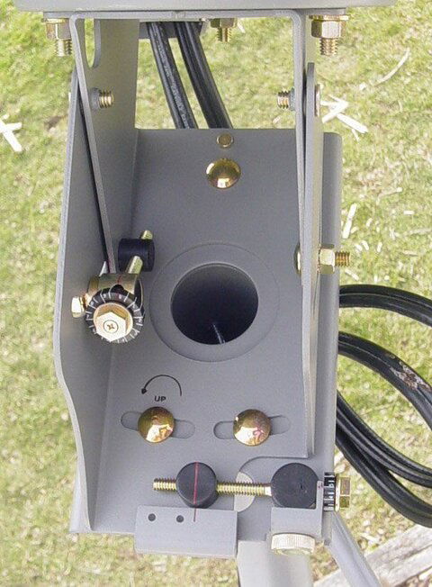

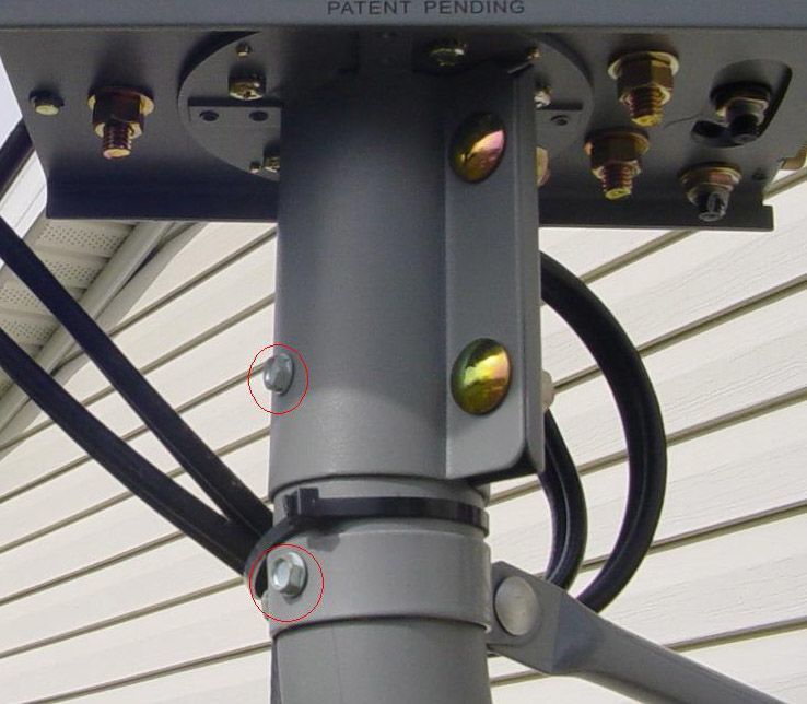

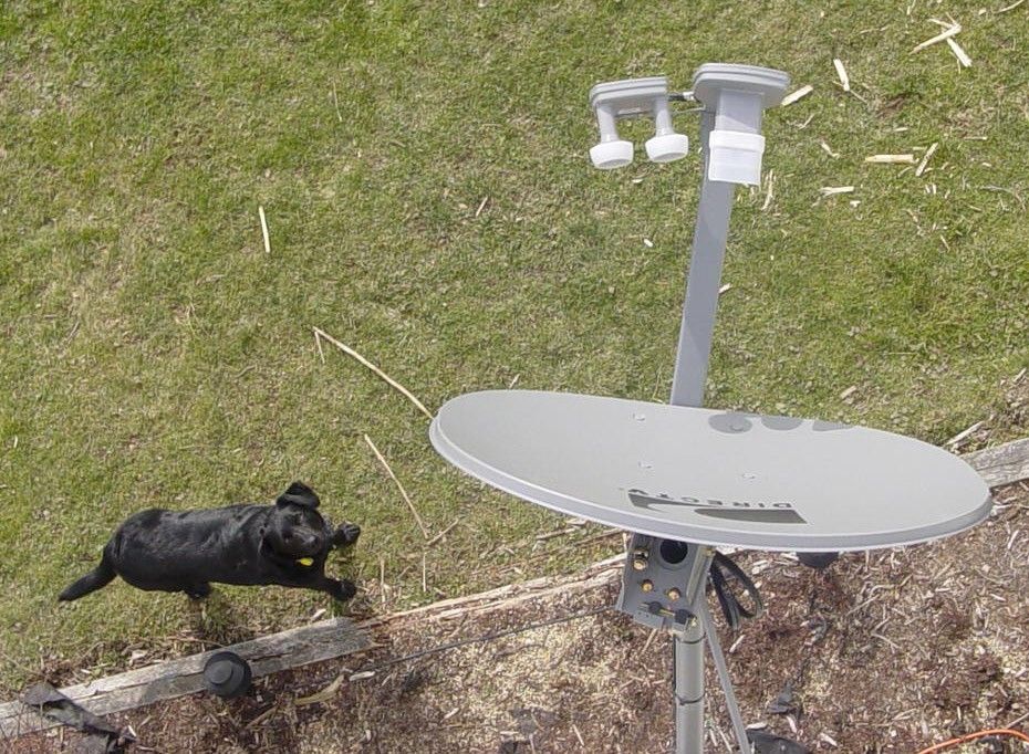

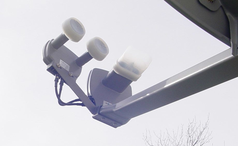

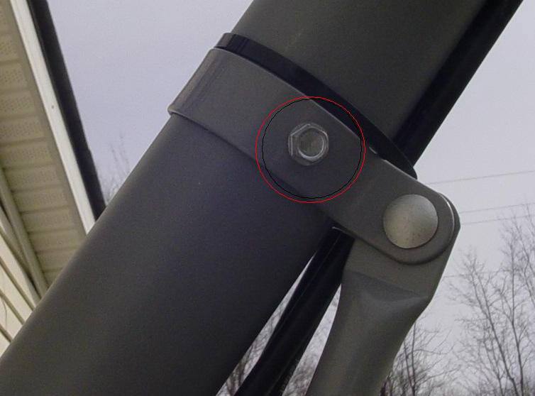

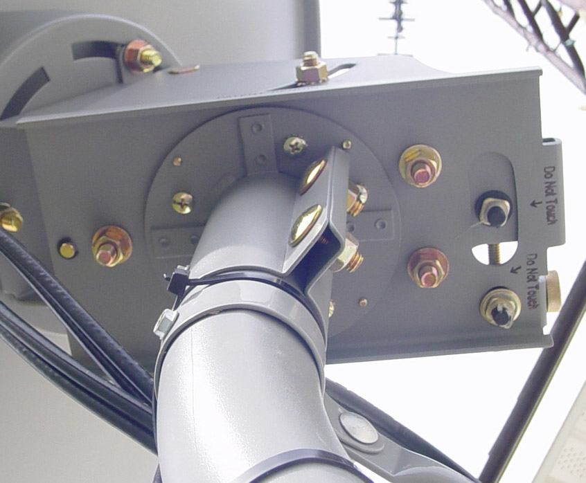

Again there are pictures of them on my site. Any joint that has the chance of moving in the future. If 2 pieces were put together on site then it would be a good idea to screw them together incase the bolts that clamp them together come loose.
dragon002 said:
they are supposed to form a triangle to stop back and forth (horizontal) movement in high winds. using only one only stops vertical movement. we at the MSPs got a memo that using anything but both is an auto fail if it is QCd
I've noticed most of the AT9 installs in my area are done without adding any of the support arms you speak of. They are mounted on top of the roof over the eves with lag bolts only. I'm a little worried that my installer (this sat) may do the same and not add the support arms. Can I 'suggest' he add the arms per the dishs' instructions? I don't want to micro manage him but I also don't want the dish to move when it gets windy.

Photos #1 Uploaded for Eric
Photos #2 Uploaded for Eric

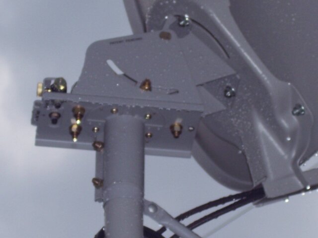

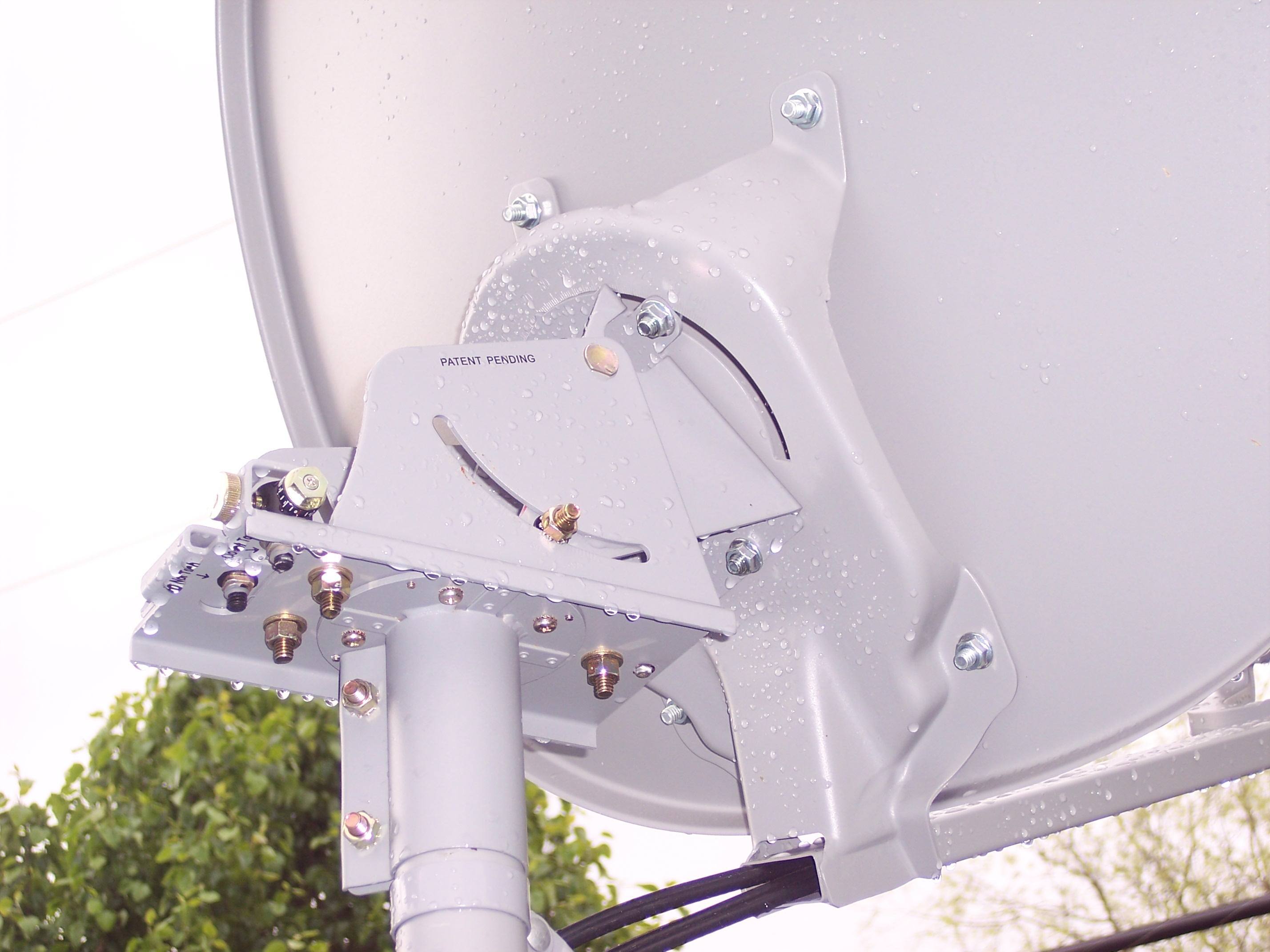

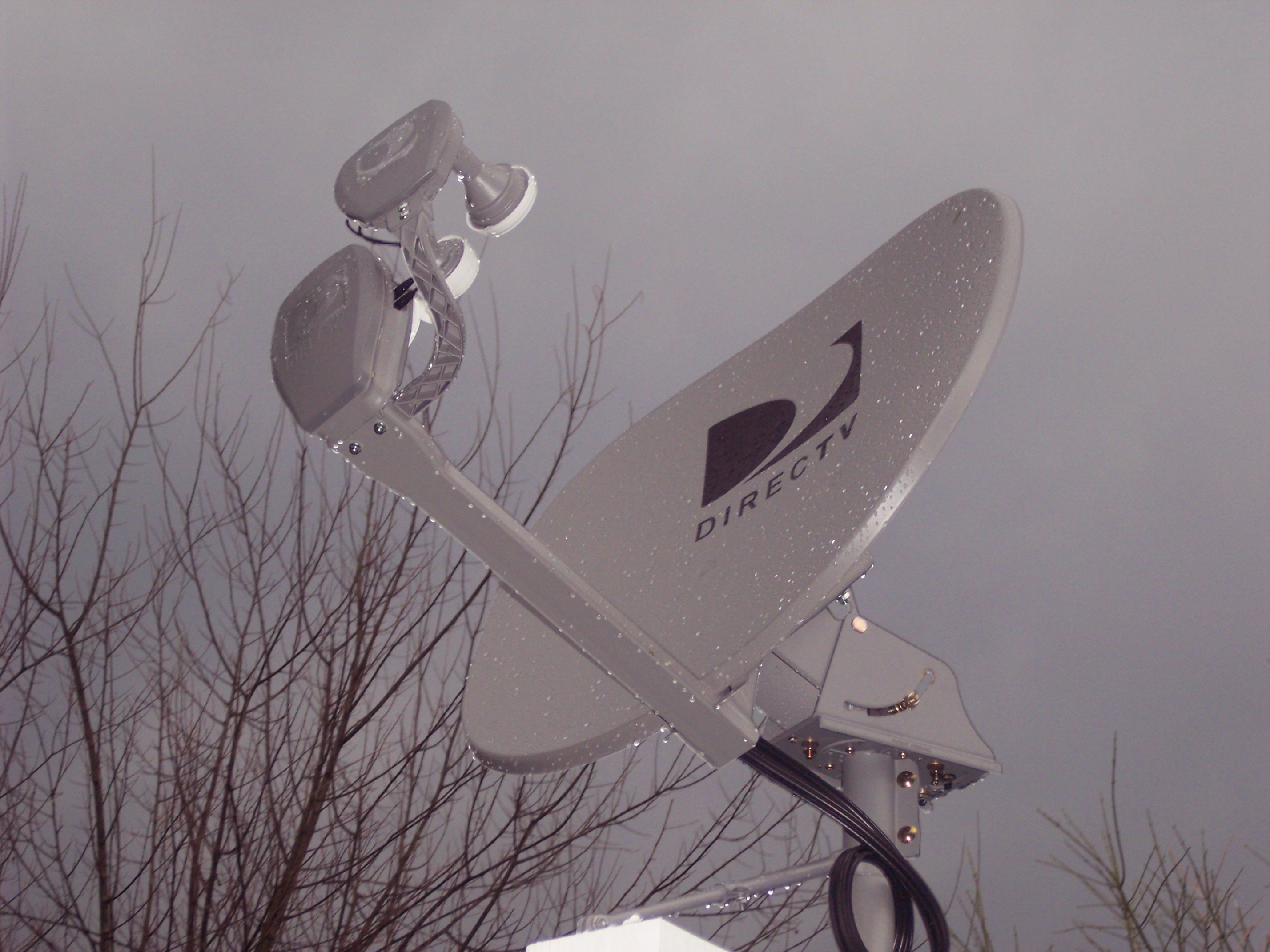

We had new D* service installed on 3/23.Here are some pics of the dish.I will try and get some better pics of it later.I took these pics yesterday,after a line of severe storms moved through our area.This dish is mounted on a post.Due to a line of sight issue (too many trees and hilly terrain),the only options we had was either a post mount or a commercial roof mount.The missus nixed the roof option in a heartbeat,so it went on a post.I feel like the tech done a helluva job with the install,especially after the storms we had yesterday (high winds,large hail and heavy rains).It is still working just fine,no loss of signal or picture freeze,even with the bad weather that is currently in this area.

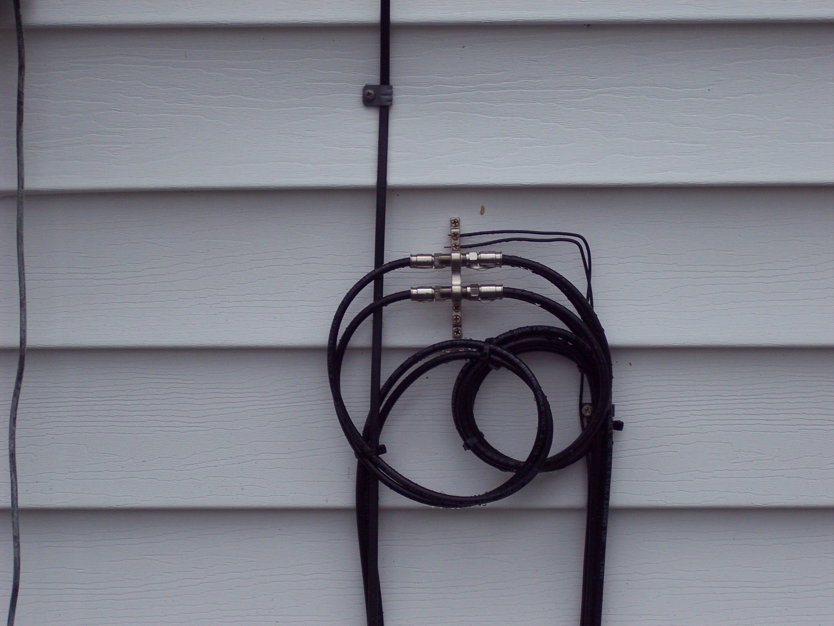

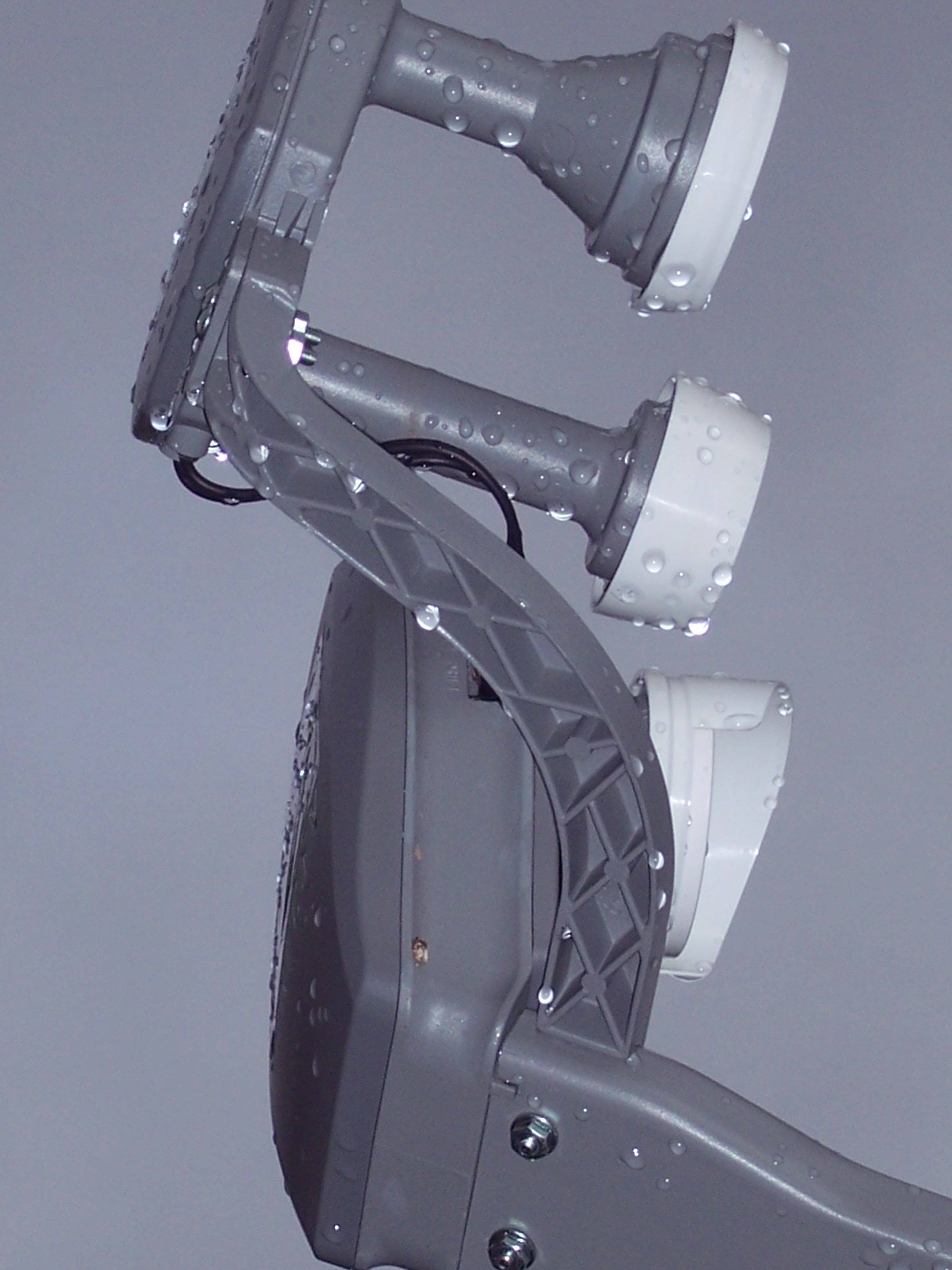

Here is some more pics of our AT9 install.
dragon002 said:
nice clean job.

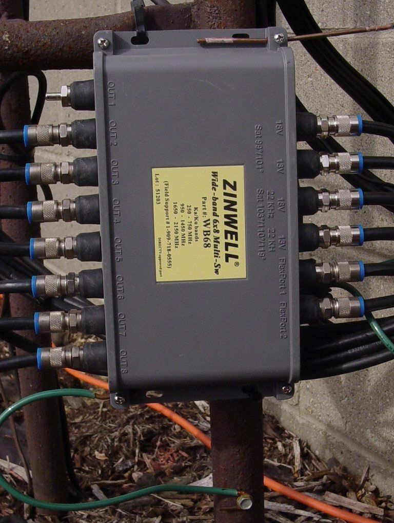

Thanks dragon,I thought he done a great job.:up :D Edit:The 6x8 multiswitch was also on the work order,I don't know why.But,he gave us one of the multiswitches,because it was listed on the work order.
