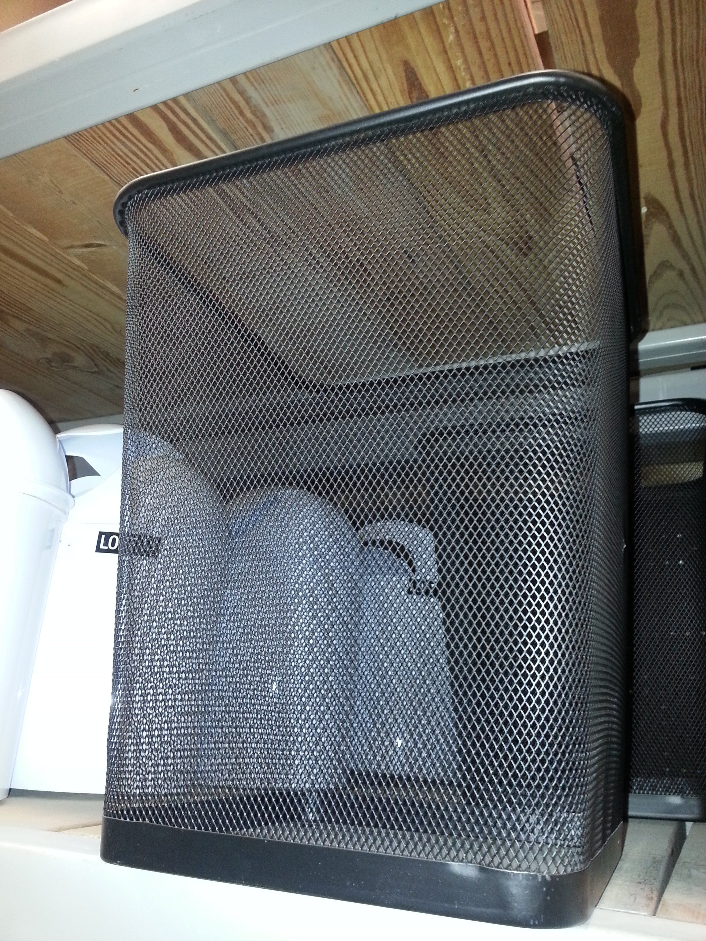

Simple rip-cuts can be flattened together, and hand stitched with picture hanging wire. It works well, and you could even paint it if you feel the need. Though the sort of repair is pretty invisible to most people, even looking right at it. No need to spend money buying, cutting, welding and all that.
Hey, that 's a great idea you guys. The small 6 inch slice on one panel, I could repair very easy. I also plan to use my better paint sprayer to spray paint the entire dish. Thanks again!
